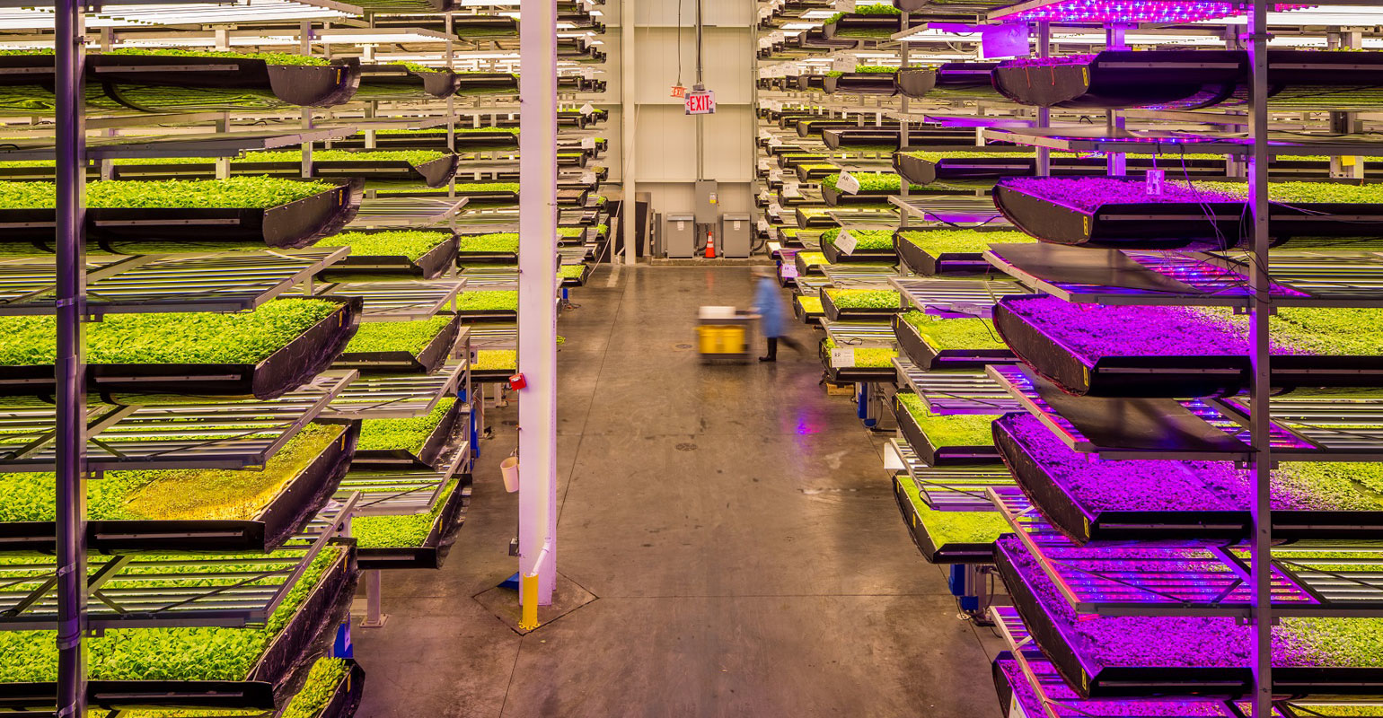

    Its current and prospective role in the market is varied. Vertical farming, an emerging concept of stacked, high-density indoor plant production that uses no natural sunlight, has been mid-wived by LED’s ability to optimally deliver light from luminaires positioned in close proximity to plants. Artificial light-supplemented greenhouses, a small, but growing sub-sector of a production approach that mostly uses natural light, are candidates for moving away from clunky legacy lighting to energy-saving, cool-operating, and tunable LED sources. And so-called non-stacked indoor farming, which utilizes only artificial light, and has been surging with more legal cannabis production, could find LED to be an economically superior alternative to incumbent high-intensity discharge (HID) lighting; LEDs in that setting may prove particularly valuable for delivering precisely tuned and timed, growth-stage-appropriate light to cannabis plants.
    Indeed, across the board in CEA, LED could prove to be a game changer — to what degree depends on several factors, chief among them the payback period for investing in a lighting solution that is more expensive in the short run. That’s an important consideration, particularly for producers who grow products yielding razor-thin margins in the market. Even with attributes that bring reduced long-term operating expenses or contribute to the production of more and better products, LEDs may continue to be a hard sell for some operations.
    But one budding corner of CEA that will flock to the LED approach as it expands is vertical farming, a style built around soilless growing of selected products such as lettuce and other leafy greens and herbs. Since light-generated heat (and its potentially harmful effect on growing plants) is a big logistical obstacle for such operations, cooler LED light is ideally suited to the task. Producing less heat than light from other sources, namely fluorescent, configured to sit inches from the tops of plants, LED lighting lessens heat stress on plants while generating less heat buildup in the facility, resulting in lower costs to keep facilities in a critical temperature range.
    That’s a big reason LED is highly used in vertical farming today and is on track to be that sector’s dominant lighting source. In a 2018 research paper on the global horticulture lighting market, Strategies Unlimited estimated that 86% of the lighting in use in North American vertical farms is LED, with the balance being fluorescent lighting. And it forecasts that as the industry grows, LED usage will expand, comprising 99% of the installed base of lighting by 2022.

    Most existing vertical farming operations, eager to prove the commercial viability of the concept, are extensively utilizing highly curated LED lighting. One market leader, AeroFarms, LLC, Newark, N.J., describes its approach to lighting as one of engineering the perfect light mixture for each plant that delivers “exactly the spectrum, intensity, and frequency they need for photosynthesis in the most energy-efficient way possible that allows us to control size, shape, texture, color, flavor, and nutrition with razor-sharp precision and increased productivity.”
    A November 18 Washington Post story on the vertical farming phenomenon referenced work by researchers at Michigan State University to understand the nuances of LED light recipes and their effects on plants. One finding noted is that varied intensity mixtures of red, blue, and green light produced different feature expressions in a red leaf lettuce variety, relating to leaf size and shape and coloring, and even yield.
    This ability to capture LED’s uniquely adjustable qualities — coupled with tangible gains in product quality, production intensity, and yield — could ultimately prove more valuable to vertical farming operations than energy savings, especially since LED is the only practical grow-lighting solution.
    “The biggest selling point (especially for vertical farms) may be increased productivity,” Smallwood says. “The light spectrum matters and that has an impact on how quickly plants bloom and the quality of the plant through different phases of its life cycle. That [understanding] could drive deeper penetration of LEDs, even at higher price points.”
