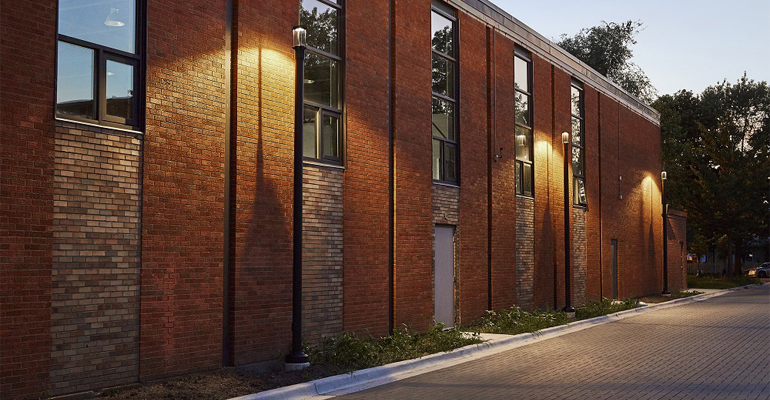

Luminis fixtures were ultimately selected by the lighting designer at CharterSills to illuminate the driveways and walkways throughout the residential complex while complementing the original architectural design of Lathrop.
“We were looking for a pole fixture with a clean, architectural profile that didn’t compete with the surrounding landscaping,” says Erin Held, design director at CharterSills, and lighting designer for the project. “And we wanted a luminaire that offered multiple distributions.”
Held selected the company’s luminaires with Type III distribution for the fixtures adjacent to the residential buildings, ensuring there was enough light pushed down to the nearby pathways without residual glare directed at the residence windows. Fixtures further along the paths and driveways feature a Type V distribution, where light is equally dispersed to the ground below, providing a safe, well-lit environment.
The luminaires also have a 3000°K color temperature, so residents and guests experience a warm illumination as they enter the complex.
Each of the 65 luminaires is affixed to a 5-in. diameter round aluminum pole designed to offer maximum resistance to wind load. The components are made of a corrosion-resistant aluminum alloy and hardware is stainless steel, with a powder coating, to protect against Chicago winters.
