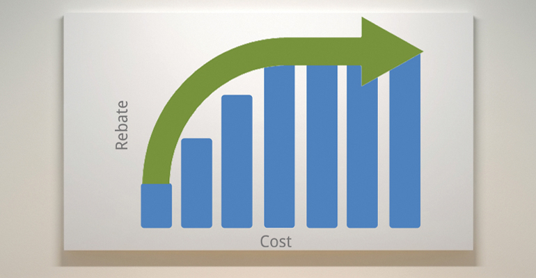

    According to BriteSwitch, a firm specializing in capturing local, utility, state, and federal rebates and incentives for businesses, many people are disappointed when they see a high advertised rebate amount to only later realize they received a much smaller rebate than expected. This discrepancy can happen because of cost caps. In the fine print on most rebate applications in North America, there is a cap of how much of the cost they will cover. This way, rebate programs ensure customers also contribute a fair amount toward the new lighting.
    To learn more about the role of cost caps, BriteSwitch conducted an analysis to see their impact on the actual rebate amount.
    Material cost or project cost?
    Cost caps are based on either material cost or project cost (which is usually material cost plus labor cost, disposal fees, etc). According to our research, 37% of the rebate programs have cost caps based on material cost, while the other 63% are based on project cost. In some cases, the program may allow you to include internal costs, such as having an employee switch out lamps rather than an electrician, in the project cost with the appropriate documentation.
    How much do they cover?
    We see a lot of distributors and contractors looking for that golden opportunity, where they can sell lighting to their customers and have a rebate pay for all of it. Unfortunately, that isn’t very common anymore; only 8% of programs cover up to 100% of the total project costs. The more commonly seen cost caps are 100% material cost and 50% of the project cost. Keep in mind that these are just the cost caps; the rebate will still not exceed the determined incentive amount (i.e., the prescriptive or custom rebate amount).
    What is the impact on the rebate amount?
    If you see a rebate program showing $15 per LED tube, make sure you read all the fine print going along with it. The actual rebate you get might be much lower.
    For example, take the average rebate across North America for a 4-ft LED tube, based on replacing a 32W, 4-ft T8 with a 14W, 4-ft Type B TLED at 3,600 annual operating hours. At a sales price of $5, the average rebate after the cap is $2.65; at $10, the rebate is $3.44; and at $15, the rebate is $3.81.
