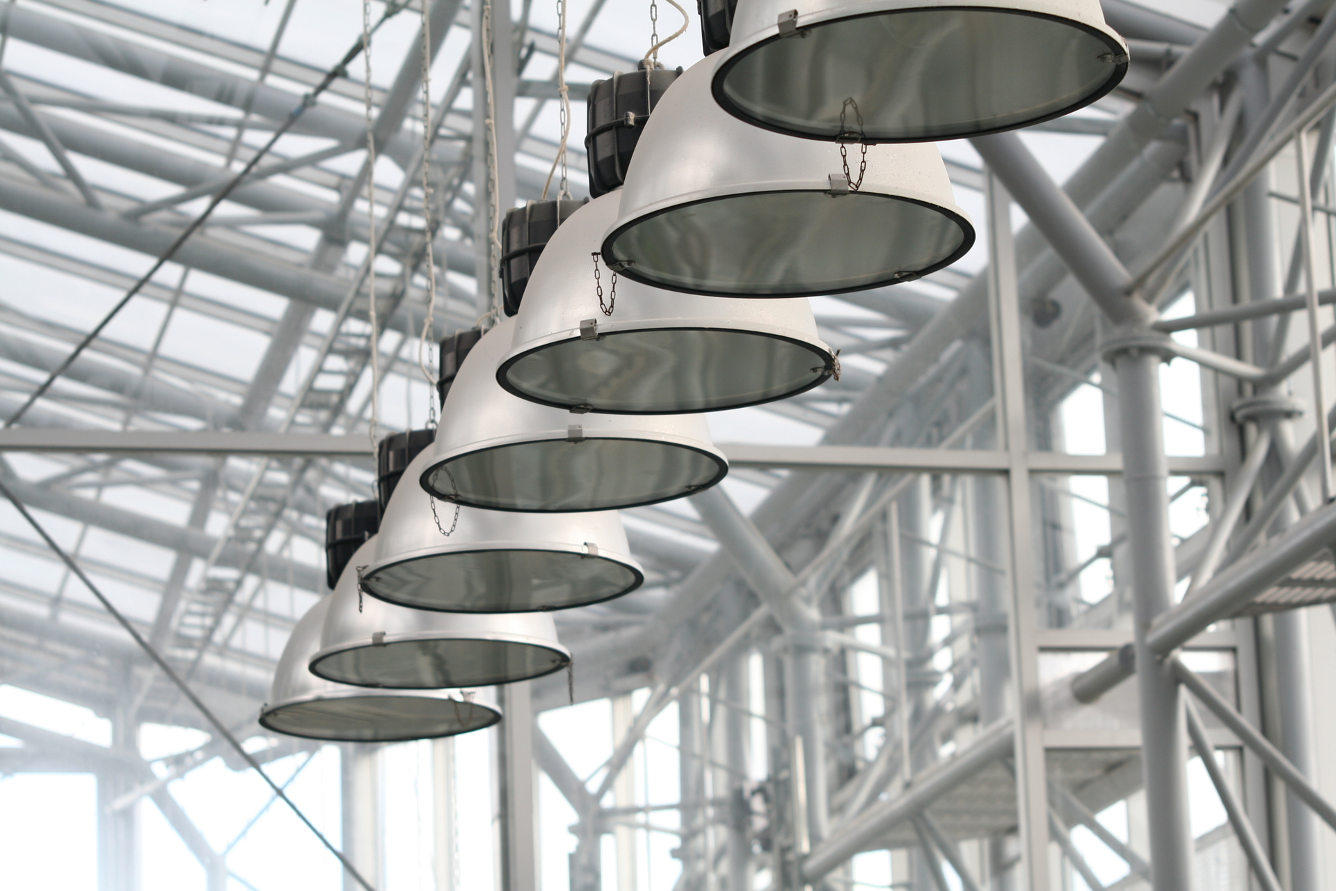

The Lighting Research Center (LRC) at Rensselaer Polytechnic Institute, Troy, N.Y., recently announced it has developed a free online tool to help growers evaluate the performance, efficiency, and economics of a variety of horticultural luminaires, typically used in greenhouses and other controlled agricultural environments. The horticulture luminaire calculator allows growers to accurately compare several luminaires and select the one that will be most effective for their particular application.
Electric lighting is essential for providing supplemental light in many greenhouses and is the only source of light for indoor agricultural environments. These lighting systems are extremely expensive to purchase and install, so it is important for growers to select a lighting system that will provide the most effective lighting for their application at the lowest overall operating cost.
The horticulture luminaire calculator developed by the LRC is based on a metric called photosynthetic photon flux density (PPFD), which is analogous to photopic illuminance on a work surface in an architectural application. Just as it is only valid to compare the power densities of alternate lighting systems at equal illuminance levels on the work plane, the power densities of alternate horticultural luminaires should only be compared when they provide the same PPFD on the plant canopy.
According to the LRC, growers can easily be misled by considering luminaire efficacy alone, when selecting lighting products for horticultural applications. In fact, luminaire efficacy does not take into account important factors such as the luminaire intensity distribution, optimal luminaire layout, and the number of luminaires that will be required to reach a criterion PPFD. All of these factors are significant when evaluating the overall cost-effectiveness of various horticulture luminaire options.
The horticulture luminaire calculator allows a grower to determine the best arrangement and mounting height of each luminaire they are considering. Using the calculator, growers can determine the number of each type of luminaire that will be needed to light their space to their desired light level and select the product that will provide the optimum lighting, at the lowest cost.  It would take several days to make these calculations using traditional methods. The horticulture luminaire calculator does it in a manner of minutes.
