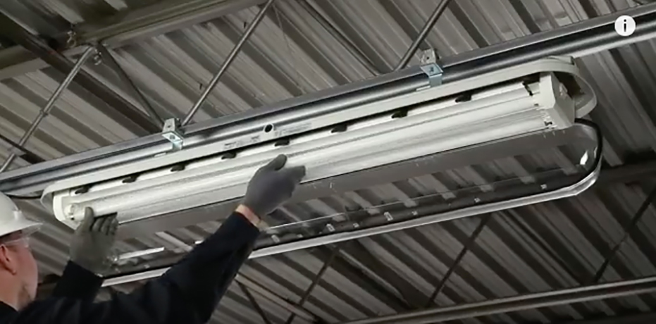

Frustrated by frequent maintenance, poorly lit areas, and high-energy consumption, you’ve decided to upgrade your facility’s lighting. You’ve obtained the manager’s approval for the retrofit and are eager to begin the switch to LEDs, but before you purchase the luminaires and jump into installation, consider the following factors.

6. Research true 1-for-1 retrofit solutions. Is the LED solution you’re considering a true 1-for-1 retrofit for your facility? If not, do you have enough circuits available to add more luminaires? Labor costs are a key factor in any retrofit project. Can you mount directly to the existing mounting hoods? If so, this can save a significant amount of labor and cost.
7. Reconsider facility obstructions. Are there any obstructions in the ceiling that might block light or prevent access to the luminaires? Consider alternate mounting means for the luminaires, such as pendant mount. For example, many task luminaires have multiple mounting hoods to ensure the luminaire is installed in the ideal location to properly light the area.
