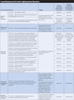

Indoor alteration requirements are now simpler and easier to apply in practice. Compliance thresholds and exemptions are now consistent across all compliance options. Now, alterations to indoor lighting systems that include 10% or more of the luminaires serving an enclosed space must meet one of three requirement options (see the Table below).
Option 1: Comply with the indoor lighting power and lighting control requirements for new construction (second column from right in the Table).
Option 2: Alterations using 80% or less of the indoor lighting power allowances for new construction must adhere to the lighting control requirements in the right column of the Table.
Option 3: Projects in small buildings or tenant spaces (5,000 sq ft or less) that include one-for-one luminaire alterations to more than 50 luminaires can retrofit with new luminaires or component modifications that achieve at least 40% power reductions over pre-alteration luminaires. The project must include the lighting controls shown in the right column of the Table.
If the project includes less than 10% of the luminaires in the enclosed space, or the enclosed space has just one luminaire, then the project is exempt from these requirements.
