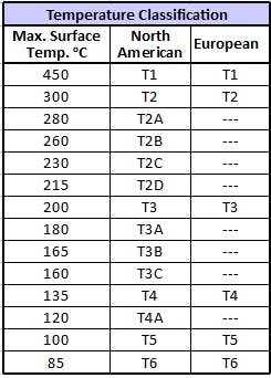

Temperatures to a “T”
Every hazardous atmosphere has a temperature that, if exceeded, will cause the flammable or combustible to ignite. Accordingly, this temperature, called the “T” rating, is a critical safety benchmark. Hazardous location luminaires must run cooler than the ignition temperature of the surrounding atmosphere. Per the “T” rating chart (see Table below), T1 rated luminaires can only be used in locations where the atmosphere needs a temperature greater than 450°C to ignite. Conversely, T6 rated luminaires run the coolest and can be used in very volatile environments where temperatures cannot exceed 85°C.
The “T” rating for a luminaire is the temperature of the hottest spot on or in the luminaire, depending on the luminaires’ Class or Zone rating. Whether the “T” rating is recorded on or in the luminaire depends on whether it is an explosionproof, flameproof, encapsulated, or enclosed and gasketed. For explosionproof, flameproof, and encapsulated luminaires, the “T” ratings are measured on the exterior of the luminaire. This is due to the explosionproof, flameproof, or encapsulated luminaire’s ability to disarm any explosion caused within the interior of the luminaire. Therefore, the exterior temperature of the luminaire becomes the foremost concern. Class II, Division 1 T-codes are also measured on the exterior of the luminaire. Enclosed & gasketed luminaires measure their “T” ratings on the inside. If a hazard is accidentally released into the atmosphere and reaches inside the luminaire, it will not ignite, assuming the luminaire’s “T” rating is below that of the hazard.
