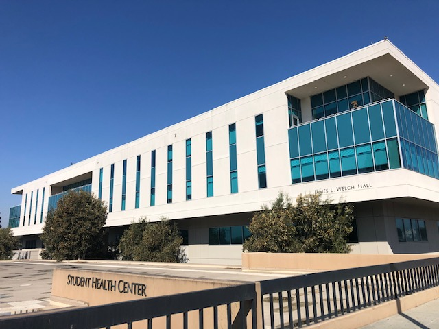

The benefits of LLLC extend beyond lighting energy savings, however. At a Leading in Los Angeles pilot demonstration site, an engaged energy manager at the Welch Hall building on the California State University Dominguez Hills Campus is taking full advantage of integrating the built-in occupancy sensors of the LLLC system with the HVAC controls. In order to conserve energy, the HVAC system can run on “unoccupied mode” if spaces are unoccupied as determined by the lighting system. In this energy saving mode, the ventilation rates and set points are dialed back to minimum requirements to avoid over-conditioning empty rooms. This integrated system approach, through the LLLC sensor, puts more granular information about space use and occupant lighting preferences in the hands of the building operator through their building automation or energy information system. Here, the energy and building managers can assure lighting and HVAC defaults are optimized for occupants and energy savings.
Since the installation of the retrofit in late 2020, lighting energy use is down 35%, while whole building energy use is down 26%, thanks to the combination of lighting and HVAC savings. The non-energy benefits are significant as well: occupants at the demonstration sites have praised the customizability of their lighting levels down to the fixture level, as well as the comfortable and inviting space created by the automated shades. Teachers in particular are able to manage glare in the classroom setting while maintaining daylight in the space.
