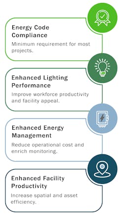

New tools make it easier to focus system capabilities and rightsize the system. After years of observing the selection and installation of lighting systems, PNNL has developed materials to assist in system selection, beginning with objectives (Fig. 3). In addition, the DesignLights Consortium recently updated its Qualified Products List of networked lighting controls. The QPL features a searchable database with filters for various capabilities.
Looking at system capabilities before purchasing products familiar to you — with their known feature sets — helps to rightsize the system. With a capabilities-first approach guiding the choices, it becomes easier to choose among the favored brands and suppliers that best fit your business approach. Rightsizing becomes routine.
For most projects, “code compliance at least cost” provides the starting point for system design or selection: just a few capabilities, including occupancy control, scheduling, daylight response, bi-level, or dimming. Of course, the details vary by code jurisdiction. For many customers, the control system can start and end with the code requirements.
For others, additional energy-oriented capabilities, such as high-end trim or energy reporting, can offer an attractive return on investment. Perhaps scene controls or tunable white lighting will enhance the appeal or productivity of high-profile areas. And some customers believe that advanced sensors and analytics promise productivity gains in the facility.
