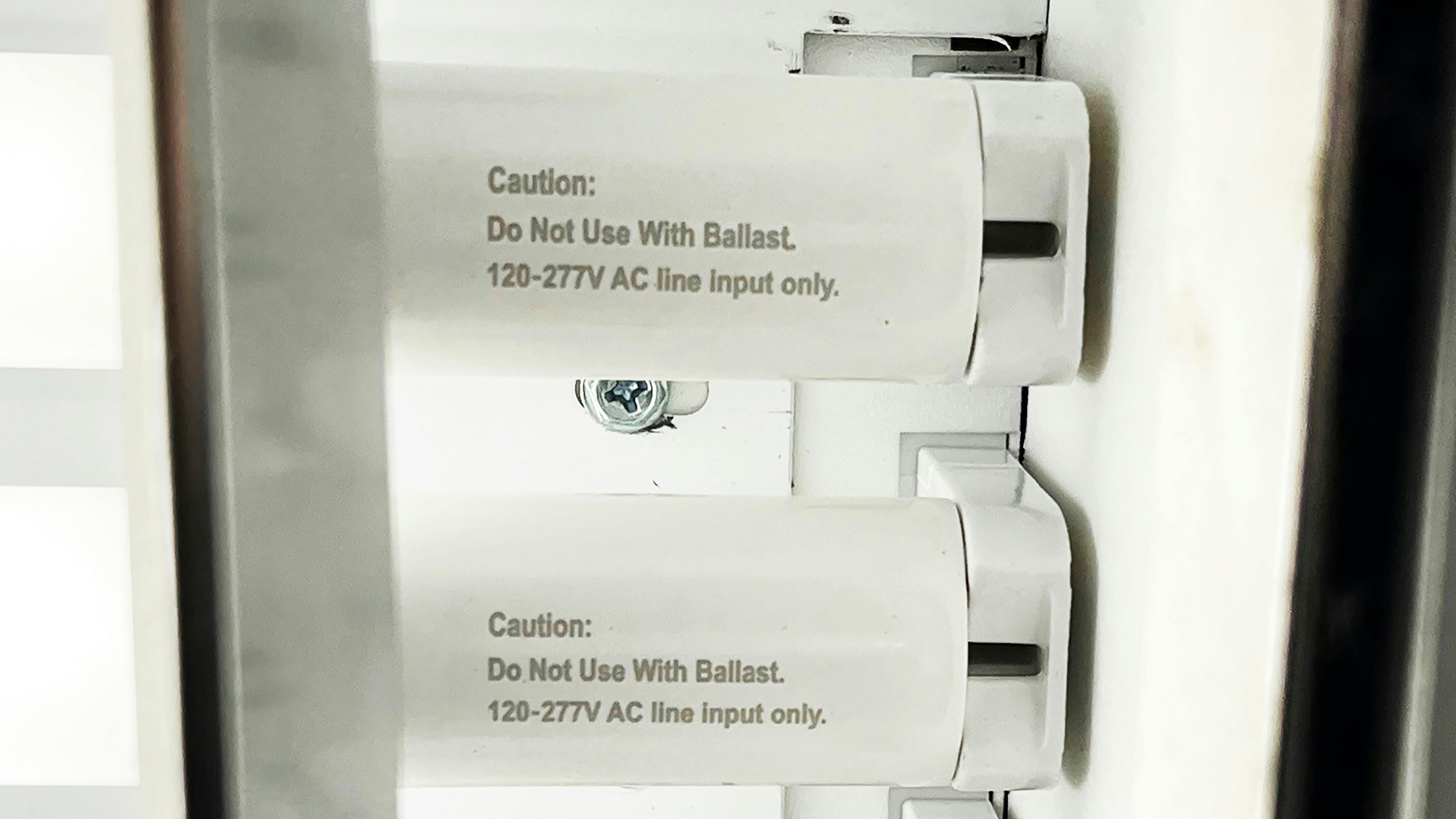

    Type B TLEDs may appear to be the easiest solution to maintain. Nevertheless, many Type Bs on the market currently are prone to flicker and may pose safety hazards if improperly rewired or relamped. During the installation of Type B TLEDs, existing ballasts are removed, and line voltage is connected directly to the lamp holders — either to one end or both. A single-ended TLED saves wiring time but poses a shock risk if the luminaire is not de-energized and a person touches the exposed end of a partially installed lamp. Double-ended TLEDs reduce the risk of shock because the ends of the lamp are not energized until they both are fitted in the socket.
    In addition, accidentally installing a fluorescent or a Type A TLED can create a fire hazard due to the lack of an appropriate power supply. Labeling of modified luminaires is required, but the wording, size, and placement of these labels vary. Examples of variable product labeling are shown in the Photo. During interviews, some school facility personnel mentioned that only electricians or trained maintenance staff change TLEDs due to these concerns. Increasing awareness of the risks as well as separating stock and limiting to one wiring configuration moving forward can greatly reduce the risks.
