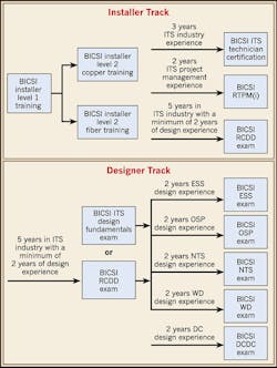

For the telecommunications infrastructure, the most prevalent vendor-neutral certifications are offered by BICSI International. Specifically, for the telecommunications system (i.e., the copper and fiber cabling), BICSI offers installer certifications: the general Installer Level 1 as well as the more advanced Installer Level 2 Copper and Installer Level 2 Fiber. These certifications are available directly through BICSI (or an authorized training facility) and simply require completion of the approved training program.
For example, University of Texas at Austin construction standards require all workers installing any part of the telecommunications
systems at the university to have a BICSI Level 1 Certified Installer credential (at minimum) and be supervised by an appropriate Level 2 Certified Installer. Alternatively, the University would consider similar training certificates from a telecommunications system manufacturer if that manufacturer’s equipment was being used on the project.
Beyond the installer certification requirements on a project, there is another common requirement the telecommunications designer and contractor might encounter. The Registered Communications Distribution Designer (RCDD) designation is awarded to those individuals who have demonstrated knowledge in the design, implementation, and integration of information technology systems and related infrastructure. To qualify to sit for the RCDD exam, BICSI requires at least five years of direct design experience — or two years, if the individual has three years of educational or installation experience (for a total of five years). Most of the time, the building owner drives the requirement for workers to have the RCDD credential.
(click here to see Figure)
For installation, it is common to see either the owner or RCDD require that the installing telecommunications contractor also have an RCDD on its staff. This is mainly for construction oversight to ensure that a fully qualified individual is aware of the installation project and ensures everything is installed to BICSI’s Telecommunications Distribution Methods Manual (TDMM). Because the installation contractor has this same design certification, it is not uncommon to see owners require them to stamp the record or as-built drawings with their RCDD stamp at the completion of the project.
Even if not directly called out, the project specifications may also silently require the installation contractor to have an RCDD on staff. Many manufacturers offer advanced system warranties of 15 to 20 years, which the owner or designer may require. In order to offer this type of warranty, the installer needs to be a certified contractor with that manufacturer. (Note: Some, but not all, of these manufacturers require an RCDD on staff in order for a company to become certified.) Either way, it’s worth checking the specifications closely for an RCDD and/or an advanced system warranty requirement.
If any portion of the telecommunications project falls outside the building envelope, then another certification might come into play — the Outside Plant (OSP) designation, which is awarded to individuals who have demonstrated knowledge in OSP right-of-way and route design; space design (maintenance holes, ducts, vaults); underground, direct-buried, and aerial plant design; cabling hardware; and grounding, bonding, and electrical protection systems. To qualify to sit for the OSP exam, BICSI requires two years of verifiable OSP design and either having already passed the RCDD exam or ITS Design Fundamentals exam. This last prerequisite offers someone wanting an OSP designation a way to attain it without first having to have five years of experience and pass the RCDD exam.

  • Network Technology Systems (NTS) designer
  • Wireless Designer (WD)
  • Data Center Design Consultant (DCDC)
Although geared more toward the planning and design portion of the project, don’t be surprised if an owner requires the installer/contractor to have one or more of these certifications. The NTS and WD exams are each based on their own reference manual, whereas the DCDC exam encompasses questions derived from three different BICSI publications. In addition, to be eligible for the NTS and WD exams, you need two years of experience and either a current RCDD status or proof of passing the ITS Fundamentals exam. To qualify for the DCDC exam, you must have two years of verifiable experience.

Recognizing the convergence of security and IT systems, BICSI now offers an Electronic Safety and Security (ESS) design certification. This exam is eligible to those with two years of verifiable electronic safety and security system design who have previously passed the RCDD or ITS Fundamentals exam. It is based inclusively on its Electronic Safety and Security Design Reference Manual.
