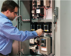

An MCP typically has a single dial called a magnetic adjustment range. After determining the motor's FLA from its nameplate, the electrical worker refers to NEC Table 430.52 and selects the appropriate initial breaker trip level, then rotates the dial with a screwdriver to the selected setting. Following that is the process of trial and error described earlier — if the MCP doesn't trip upon start-up, the trip level should be reduced until it does, and vice versa if it does trip initially.
