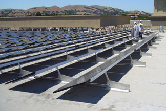

A solar array design and configuration can be simple or complex (see Solar Electric Market Segments). Vendors offer products to meet both situations. For the straightforward design, many suppliers offer off-the-rack components. When the site requires more sophisticated engineering, such as a seismic or high wind zone, a few vendors offer an array design and engineering support as part of the package.
When reviewing an array's interface with the site (in most cases a rooftop), two issues emerge. One is the structural integrity of the roof — for this, contractors will need the involvement of a structural engineer. Secondly, depending on the attachment method, the array can impact the operation of the roof in terms of access, drainage, and wear and tear. Contractors should discuss these issues with a mounting supplier and a skilled roofer.
Perhaps the biggest challenge faced is in the area of securing the system to the site. The ideal mounting system safely secures the array by meeting the code requirements demanded by the location, but at the same time does not adversely impact the roof. Contractors can be caught in between competing interests of the permitting authority who wants a supremely secured array and the building owner who doesn't what his roof compromised. Electrical contractors will find that engineering issues of wind loads, exposure class, and seismic activity require surprisingly sophisticated solutions to keep the array in place without punching holes in their client's roof.
Grounding, string layout, and wire management can add some additional nuances to the installation. A PV system can involve thousands of module-to-module connections, making the installation look more like a production process than a custom installation.

Commercial flat roof — Commercial flat roof applications represent the lion's share of megawatts installed and possibly the biggest opportunity for contractors to expand their businesses. Warehouses and big box retailers have sizable roofs and significant energy bills.
