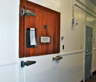

Let's take a look at a typical walk-in refrigeration unit (Photo 1) to gain a better understanding of how these systems work. This particular unit consists of a well-insulated room with a heavy gasketed door with single-acting push hardware on the inside. High up near the opposite wall (hanging from the ceiling), one or more evaporators (Photo 2) are mounted. The cold refrigerant passes through this unit and goes back to the compressor located outside the walk-in via a low-pressure return line. The evaporator consists of pipe arranged in a flat coil configuration with cooling fins attached — quite similar to an automotive radiator. Other features include a fairly powerful electrical motor with a fan blade attached to the shaft, a sturdy guard to prevent injury, and a sheet metal shroud for further protection.
