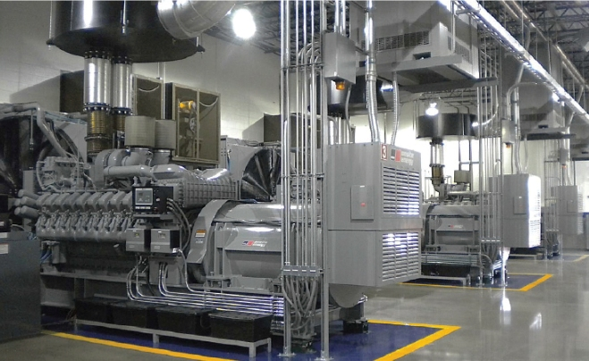

Rather than add to the mix of existing standby generators, which had been cobbled together as the hospital grew, The Medical Center decided to replace all of them with a new central power plant, located across the street from the main hospital in a free-standing building, equipped with four 2,500kW gen-sets from MTU Onsite Energy.
With a total capacity of 10MW, the plant is more than capable of meeting the hospital’s energy needs. “Even if two of the plant’s 2.5MW generators failed, we could still run on the other two and not have any issues,” says Mark Smith, the hospital’s director of facilities management.

The gen-sets generate power at 12,470V. The ability of the generators to operate at this high voltage enables them to match the incoming utility voltage and avoid energy-wasting transformers between the utility and the central plant. Also, by generating at this high voltage, electricity travels more efficiently through the underground cables connecting the central plant to the hospital across the street.
Even the layout of the new central plant contributes to the system’s efficiency. For example, the design engineer arranged the four gen-sets so that the exhaust vents from the engines and the cooling air intake vents for the radiators were located on the same side of the building. This design makes sure that the exhaust gases do not reenter the building, and it allows all of the switchgear to be grouped together along the other side of the building, resulting in more efficient use of space and easier maintenance access.
