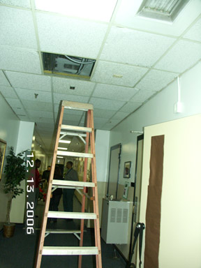

    Disconnects were typically located on one of the corridor walls above the ceilings within 10 feet of the unit. Because the units were 6 feet wide and only had a few inches of clearance above the ceiling tiles, removing a center tile and looking each way was not an option. Ductwork presented similar interference problems. After climbing up the fiberglass ladder, he began to move one of the tiles above the water fountain (Photo 1). As he slid it forward, his hand unexpectedly hit an exposed 277VAC conductor. The resulting shock caused him to fall off the ladder and sustain a severe head injury.

    Upon investigation, I found the scene above the ceiling tiles quite disturbing. In addition to the abandoned items, uncovered boxes, exposed wires, and lousy cabling, the fire-rated corridor walls had multiple unstopped penetrations (Photos 2 and 3). It was obvious to me these conditions had not been observed by the consulting engineer during his field visits. Otherwise, he would have immediately required corrections based on his contractual responsibility and ethical duty as an engineer.
    I determined the cause of the accident rather quickly and easily — as well as confirmed the occurrence of electrical shock (see Accident Reenactment). The district investigation discovered a fixture whip that was abandoned and energized above the ceiling. Subsequent to my arrival, it had been found and made safe by an on-staff school district electrician (Photo 4). This whip had an overall length of about 6 feet with No. 12 AWG THHN conductors. Because the conductors protruding from the fixture plate were not covered with dust, I concluded this was the previous location of a missing luminaire. A check of the original lighting plans confirmed my suspicion — that a fixture had been planned for this location. Additional investigation revealed this whip was still hot and part of the corridor lighting circuit controlled from a panel in a locked electrical closet.
    Based on my discoveries thus far, I believed the evidence overwhelmingly supported the conclusion that a luminaire had been removed for the purpose of installing the new air-handler unit. Challenging my assertion that removal was recent and coincidental to the installation of the new air handler, the defense promptly questioned when it had been removed and by whom. In countering, I showed the air handler would not have fit in the ceiling space had the luminaire remained in place (Photo 5).
