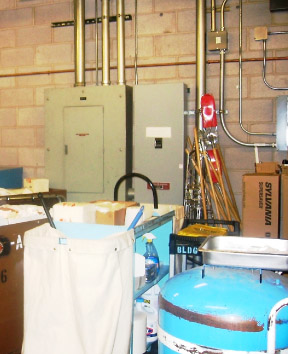

Sidebar: What to Look for During an Inspection
Proper electrical safety inspections are extremely comprehensive. The list below identifies several deficiencies commonly found during inspections:
  • Outdated one-line diagrams
  • Untrained and non-qualified operators and maintenance technicians
  • Inadequate grounding and bonding
  • Corrosion of materials and/or equipment
  • Poor maintenance practices
  • Exposed live parts — covers left off or doors left open
  • Unused openings not effectively closed
  • Working space around electrical equipment does not meet minimum requirements
  • Identification of disconnecting means missing
  • Improper, unapproved, or damaged extension cords
  • Damaged cord- and plug-connected equipment
  • Lack of electrical personal protective equipment (PPE)
