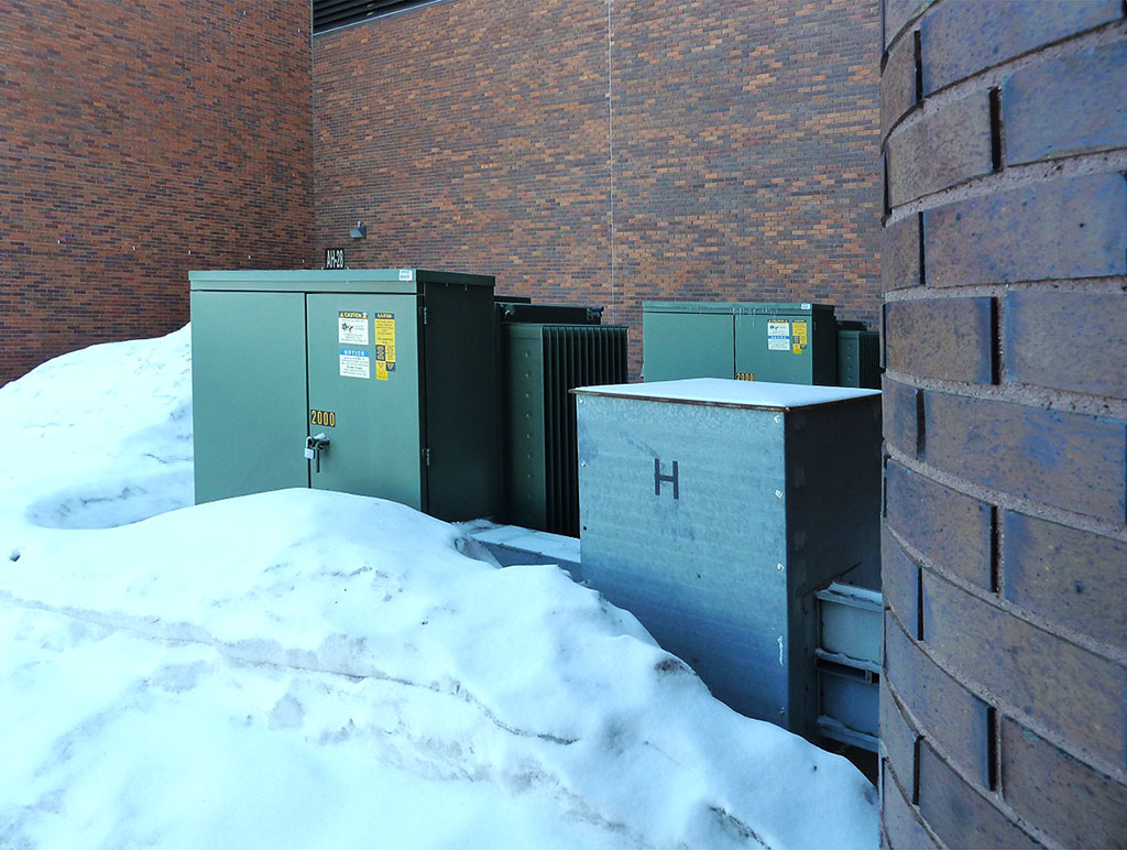

Because electric utility transformers are typically under load, they are typically not negatively affected by the cold. In fact, because they are inherently heat producers, they actually prefer colder weather. Really, the only time in the winter they are unhappy is when they are buried alive in so much snow that they cannot dissipate heat. As long as you dig them out when the blizzard hits to allow for air circulation, they’ll still be happy.
