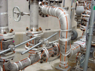

The application of heat to piping, equipment, or instrumentation to offset heat loss due to a lower ambient temperature, heat tracing is a process that can be applied through several methods, including electricity, steam, glycol, and even hot oil. Providing a basic foundation of the most common heat trace systems and components electrical professionals will likely encounter in industrial applications, this article will focus specifically on electric heat tracing and discuss the makeup of the system, methods for optimization, and tools available to assist in the estimating and design process.
Fundamentals of Electric Heat Tracing
While the general intent of heat tracing is to provide a maintained temperature, there are two commonly designed systems that handle the majority of applications. These are tracing for winterization (commonly referred to as freeze protection) and tracing for process maintenance. Winterization tracing is designed to protect the product from freezing and is typically designed to operate when the ambient temperature falls below a certain level — commonly 40°F to 50°F. Winterization tracing is typically installed on piping, equipment, and instrumentation where water (or other product with similar properties) may be exposed to freezing conditions (Photo 1). A winterization tracing system is simplistic in both design and control.
Heat tracing for process maintenance is much more complex and requires far more design considerations. This method is commonly used where higher temperatures must be maintained, and more exact temperature control is required. With process maintenance tracing, the various product flow paths must be considered during the design stage, which often results in the need for additional heater circuits and more specialized control methods. Process maintenance heat tracing is regularly used to maintain a higher temperature for the purpose of reducing product viscosity and preventing wax or hydrates from forming in the product.
Although there are numerous types of heat trace cables available, they are generally of either parallel or series resistance design. The most common parallel constructed heater cable is the self-regulating type. These cables (Photo 2a) incorporate two bus wires that are surrounded by a semiconductive polymer matrix that is high in carbon content. As the temperature of the matrix increases or decreases, a change in the chemical composition takes place, which results in a higher or lower resistance and more or less heat output. This self-regulating characteristic allows the cable to adjust its watt output at any point along the entire length of the heater circuit, helping to eliminate hot or cold spots. Self-regulating cables are used in a wide range of applications, including applications involving nonmetallic piping and equipment. Featuring a parallel design, these cables may also be cut to any length without changing the overall resistance of the cable.
