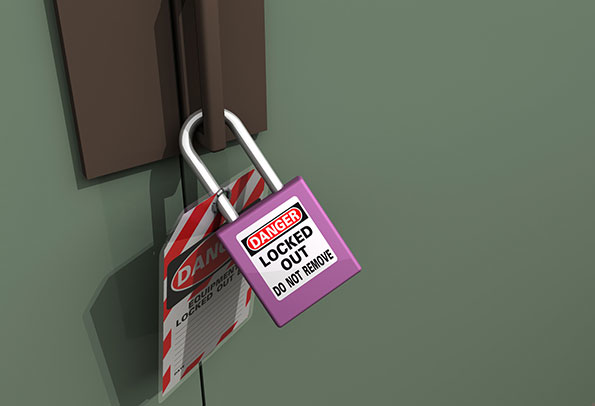

    What can happen is you go to the panel to energize the circuit for functional testing, but the operators have their tag on your lock. “By rights” you can just remove their “illegal” tag, but that could get someone killed. Make sure they remove their tag before you remove yours. If this creates a work stoppage, report the incident to the project manager.
