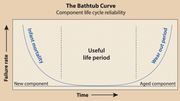

Fig. 1. The “bathtub” curve shows the three key periods of a component’s life cycle.
Let’s take a closer look at when electrical equipment is likely to wear out. As you can see in the classic “bathtub” curve in Fig. 1, there is a much higher failure rate for equipment at both the beginning and the end of its life cycle. At the beginning of a component’s life, there is a higher “infant mortality” rate. Failures are typically due to a manufacturing issue, a missing or incorrectly installed part, or a defective piece of equipment. As time progresses, failure rates decrease, and the equipment moves into its “useful life period.” During this phase, there is a low “constant” failure rate. While you may have to replace parts or perform maintenance work, this is when fewer equipment failures are encountered. Over time, with wear on the equipment, the failure rate begins to steadily rise. When equipment becomes less dependable, you’re entering the “wear out period” for the component.
