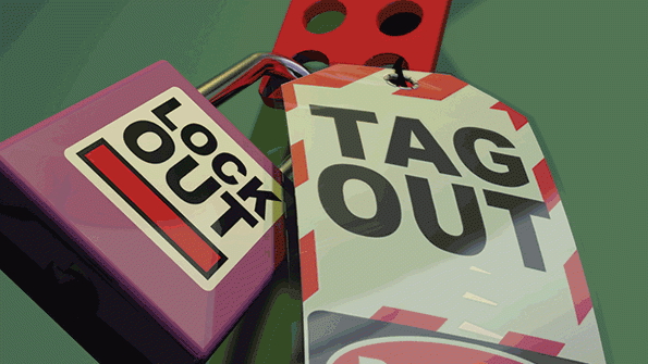

Never put one lock through another lock. If you need multiple locks on a single disconnecting mechanism, use a multi-lock hasp. This way, each lock can do its job (locking out the mechanism).
Always hang a tag with a lock. This way, people know who affixed that lock and when. Always remove the tag when you remove the lock.
