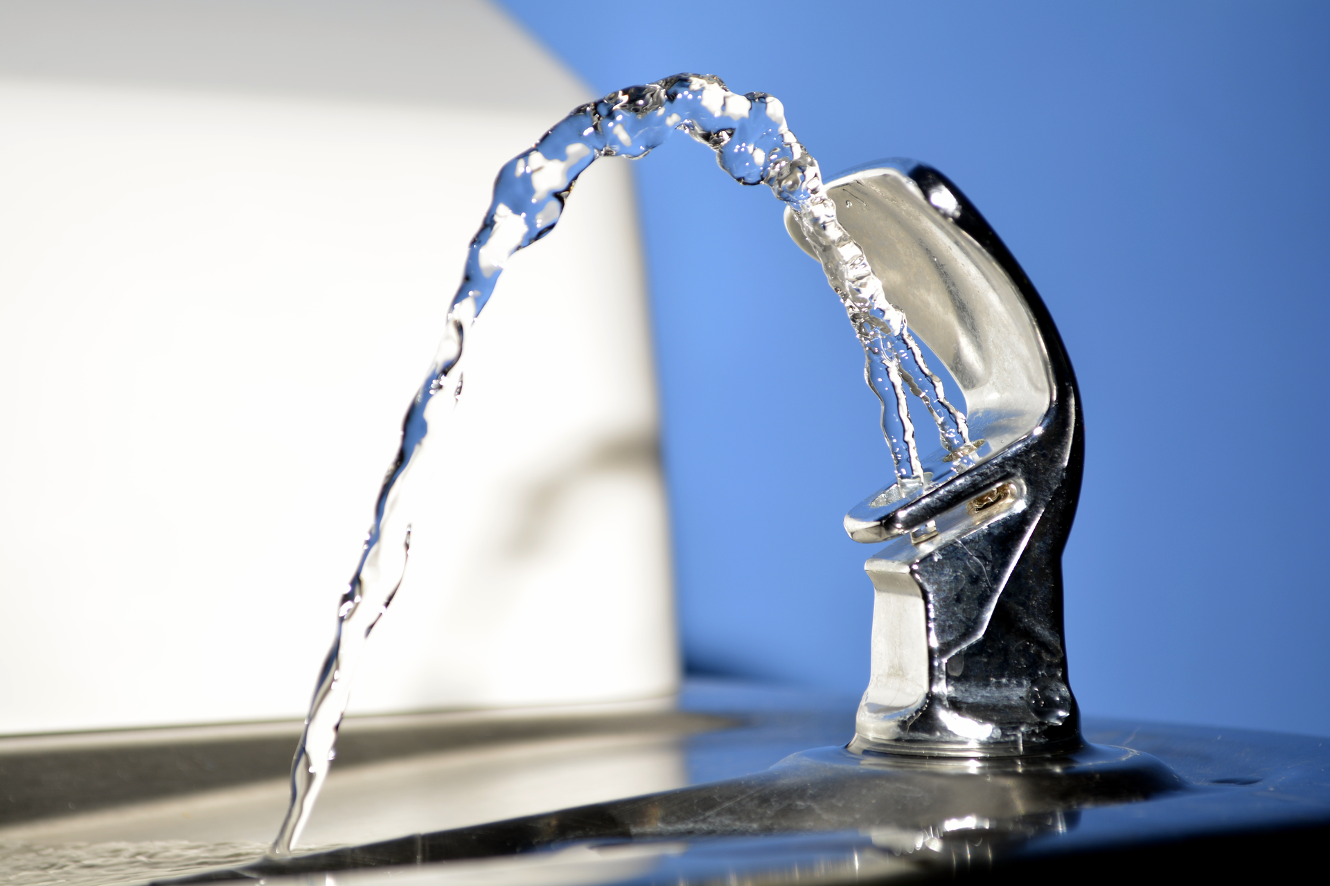

A similar thing happened with motors a few months ago. After a series of failures, motors stopped failing. Some operators complain of feeling their fingers tingle during changeovers, and others don't. Several people have complained of “feeling electricity” while using a water fountain. But even at the same fountain, this problem seems to occur randomly.

  • Improper bonding. Ensure all non current-carrying metallic objects of any size are bonded to the EGC. Ground rods won't suffice. How are those water fountains bonded?
