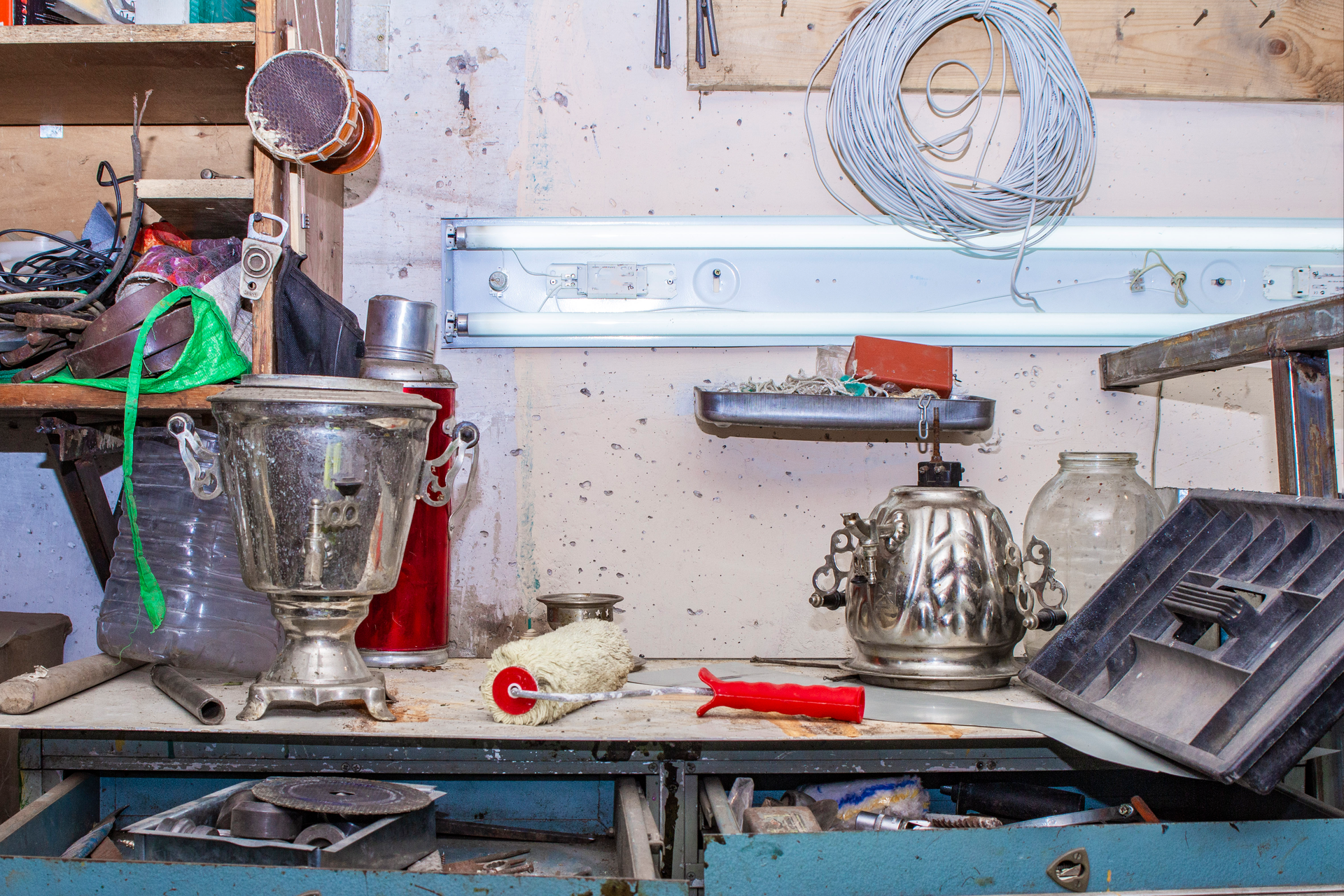

If you enter an equipment closet or transformer vault and find file boxes and fluorescent lamps stored in there, what do you do? You could try to work around them, but that would be dangerous. Therefore, you move them out of the way, right?
When you're done with the job, do you put those items back where they were so as not to antagonize anyone? Yes, if you want to perpetuate an unsafe condition and be complicit in making it exist.
