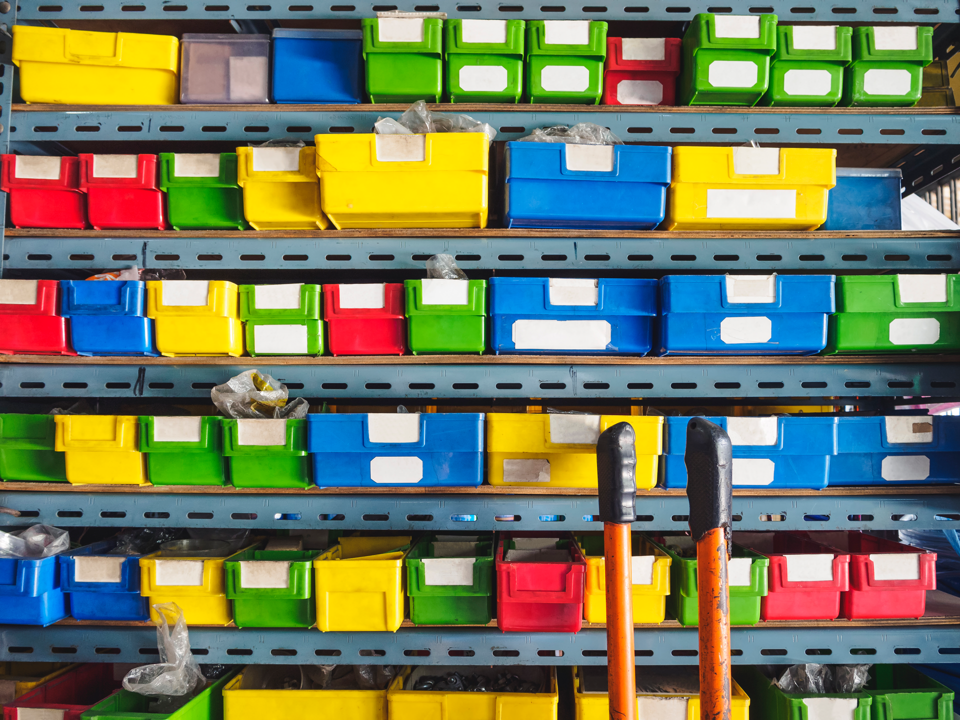

    How do you eliminate being “over-insured” with spare parts? Here are some tips:
    • Standardize parts that come in all shapes and sizes (e.g., lamps, indicators, alarms, meters, connectors, fuses, etc.). Having four pieces that can be used in 150 different places costs less than having 100 pieces to accomplish the same end.
    • Maximize predictive maintenance. It's very expensive to have spare motors, and not just because of their purchase cost. Storing them properly is also expensive. Bearing failure is a major cause of motor failure. Using ultrasonics, you can anticipate this failure months ahead of time and thus reduce or eliminate the need for spares.
    • Eliminate the typical root causes of failure. Rather than do root cause analysis after the proverbial horse got out of the barn, go after those causes before the damage occurs. You already know that bonding errors, voltage imbalance, transient voltages, and poor lubrication practices are often chief causes of failure. Eliminate these, and you eliminate maybe 50% of the need for spares.
