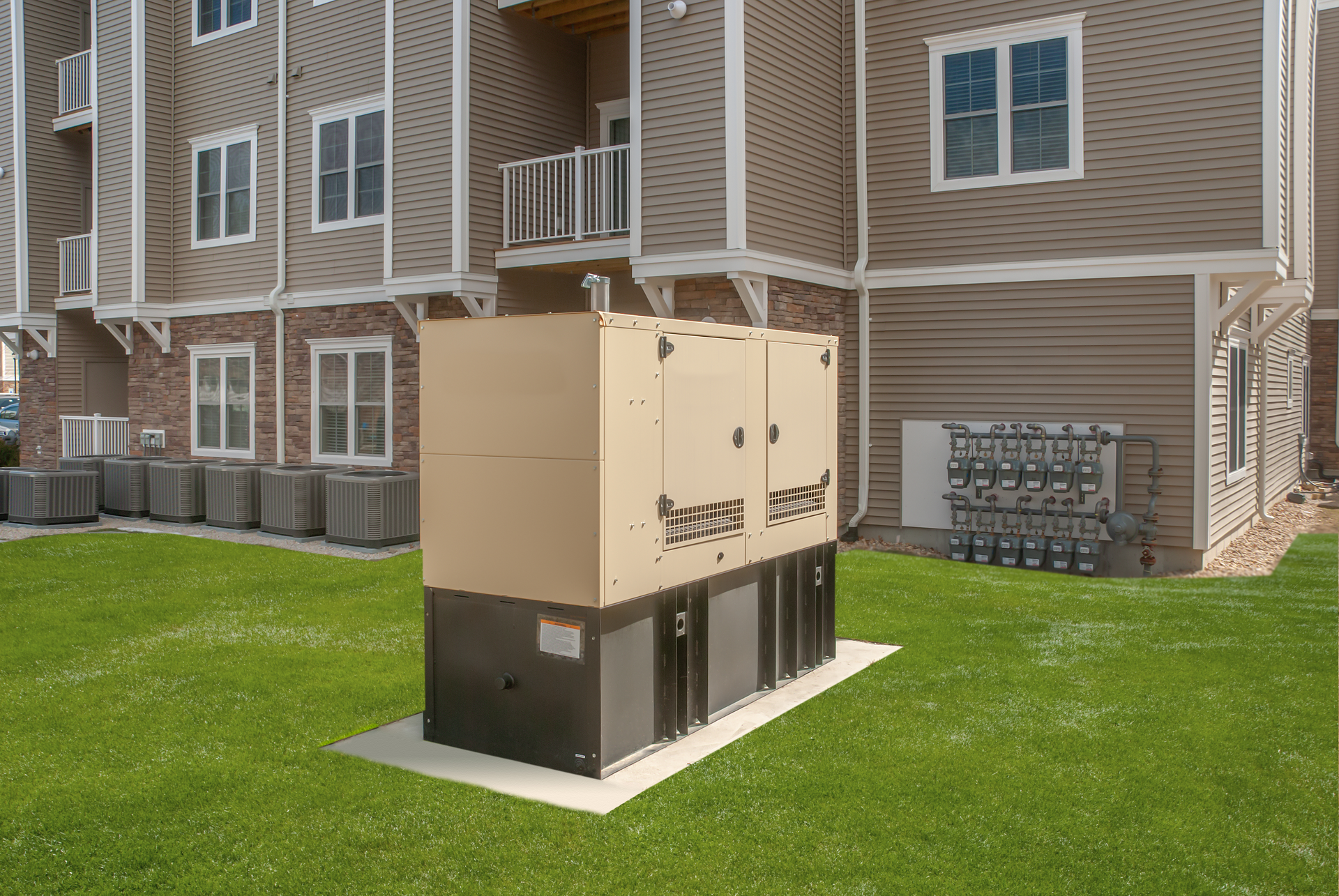

Standby systems are optional when they are intended to provide power to facilities or property where life safety does not depend upon the performance of the system.
Article 702 provides the requirements for permanently installed optional standby systems (OSS). Did you know that portable alternative power supplies, when arranged for a connection to premises wiring, are also covered by Article 702? Some highlights include:
  • OSS equipment must be suitable for the fault current at its terminals [702.4].
  • Where you have automatic transfer, the standby source must be able to supply the full load the automatic transfer equipment transfers [702.4(B)(2)(a)].
  • If your OSS is installed to permit parallel operation with the normal source, it must also meet the requirements of Article 705 [702.5(E)].
  • Where practical, audible and visual signals must be provided to indicate malfunction of the OSS and to indicate when the OSS is carrying load [702.6]. This rule does not apply to portable standby power sources.
  • Wiring for the OSS can occupy the same raceways, cables, boxes, and cabinets with other general wiring [702.10].
