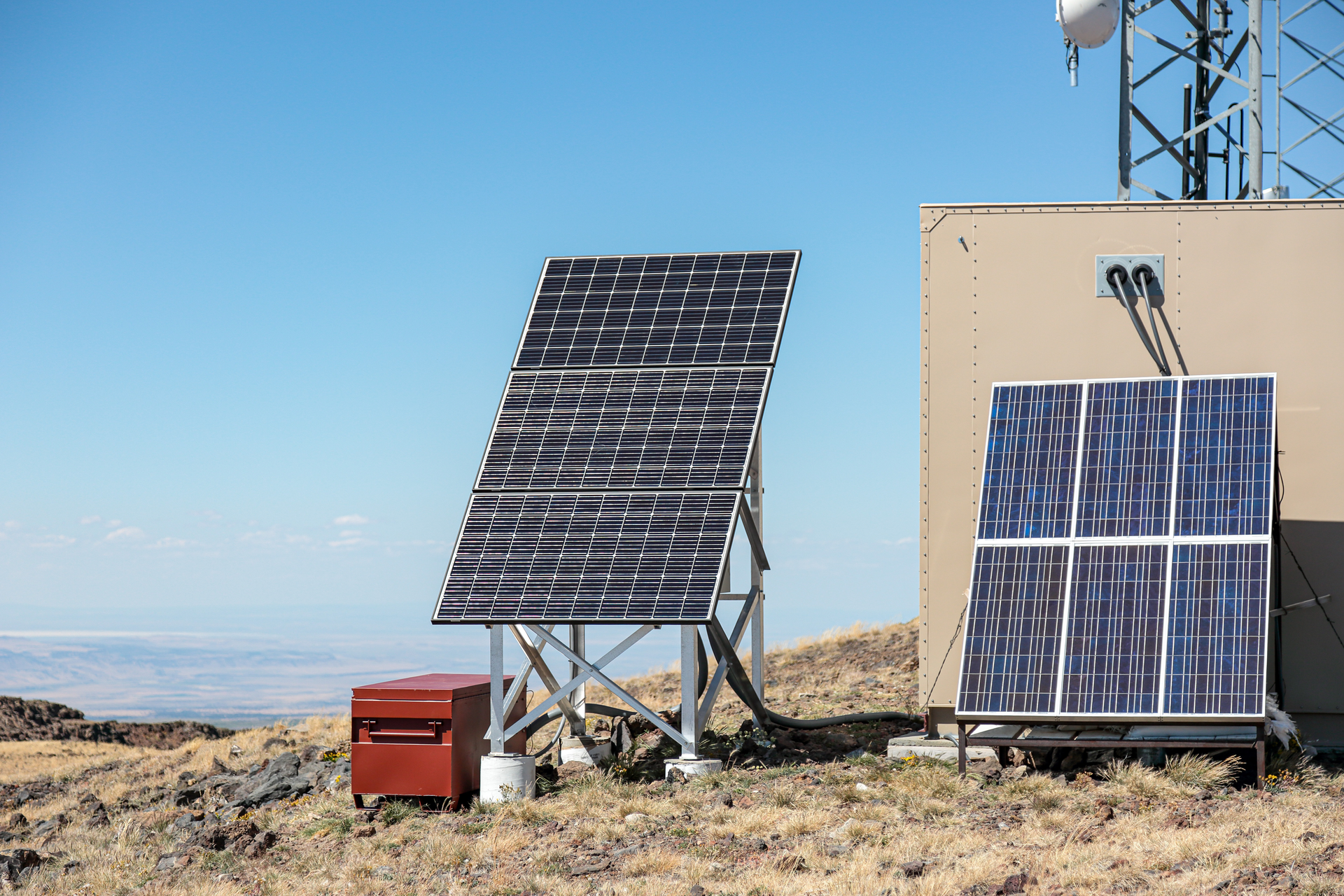

Article 710 of the National Electrical Code (NEC) provides the requirements for power systems that operate in island mode and installations not connected to a power production and distribution network. These are in contrast to the interconnected systems covered by Article 705.
For example, a remote building may have its own solar power or wind supply. When it’s impractical to run utility power, this arrangement is often a solution. But even when utility power is available on-site, there may be a building or area with its own off-grid power system. Microgrids are an increasingly common example of this arrangement.
