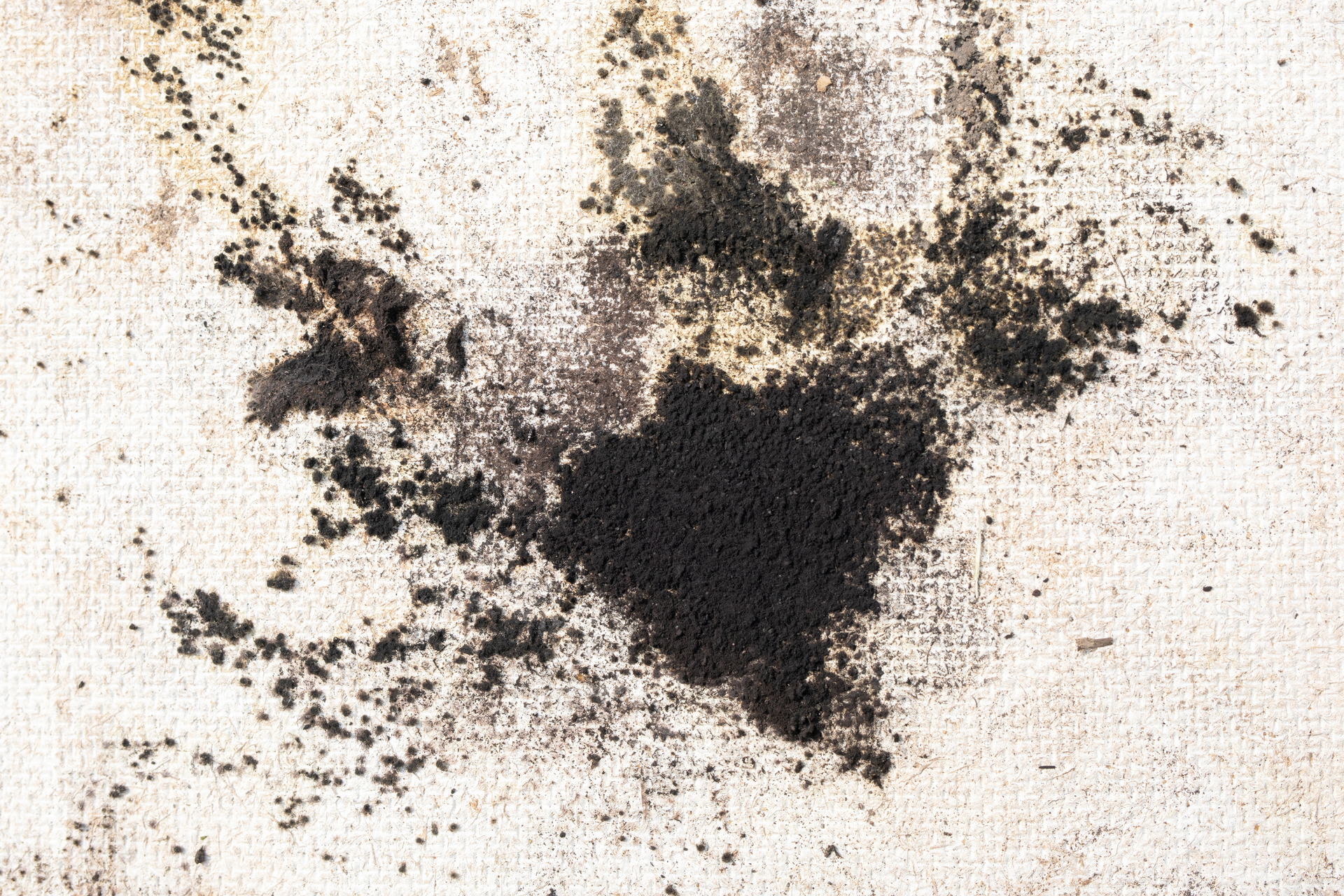

Imagine the following scenario: You’re a maintenance electrician for a multi-building plant, and each building has its own crew. You recently transferred to another building on the premises. Several lines in this building have experienced motor-related failures, and your boss thinks it’s a problem with the MCC. He shows you a repair report from the electrician you replaced. He points to one phrase and says it repeatedly: “Found and removed mold at MCC.”
You ask yourself the following questions: Was it black mold or green mold? How much mold was present? From what location was it removed? Was it on the exterior, or was it on energized parts? Was it removed with vinegar or with an antifungal agent that stops regrowth but not the cause?
