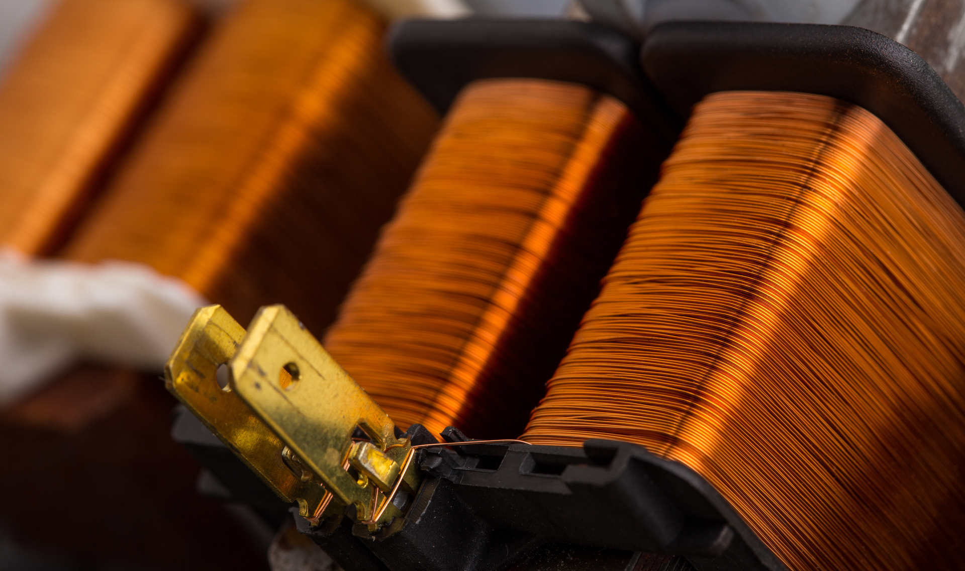

Some replacement items have absurdly long lead times. Because of significant baking time, transformers cannot be made quickly. While your electrical distributor may have a few 45kVA dry-type transformers in stock, you can’t expect them to have a 750 kVA oil-filled transformer just waiting for you the day after an intense electrical storm. Nor are they likely to be able to send a truck right over with replacements for the three 2500 kVA service transformers that just failed a battery of transformer tests.
Yet, it seldom (if ever) makes sense for smallish facilities to hold big transformers in their stock room. What are you to do?
