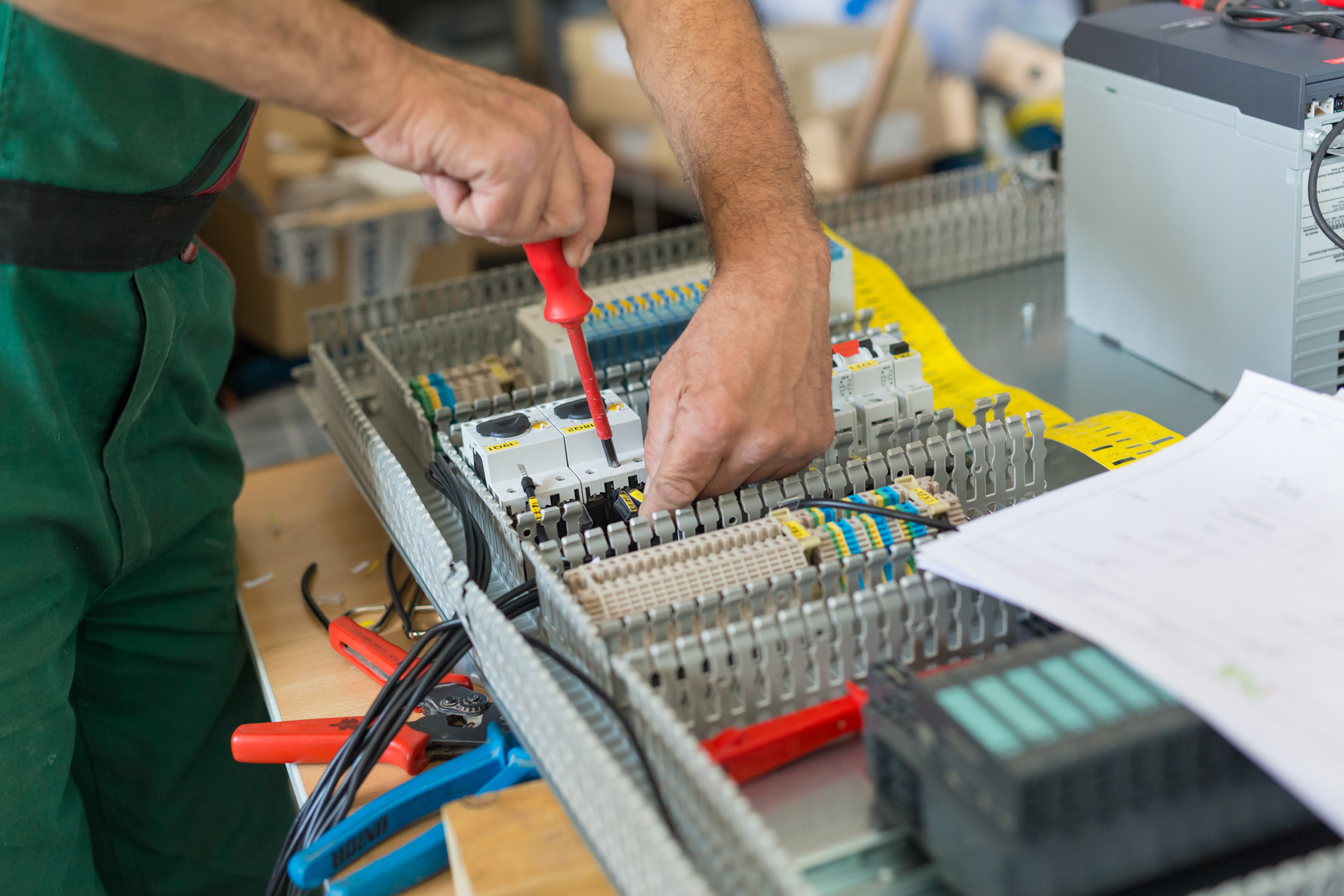

Functional zones
One way to prevent this is to create functional zones within the cabinet and run wiring between them from terminal strip to terminal strip. Eliminate all direct point-to-point wiring to or from any components; all components connect to terminal strips.
So, for example, you have a signal input zone in the upper left and a signal output zone in the lower right. In the middle, you have zones for the other functions (as determined by the control drawings, ladder logic, or other source). There are borders taped or painted around each zone. If you have to replace a component, now the orientation of its mounting is not going to create issues in the cabinet.
When a cabinet comes new from a manufacturer, it is typically going to economize by using point-to-point wiring between components — laid out for convenience of build not convenience of maintenance. It may save money now, but you’ll incur much higher costs down the road.
A relatively small investment upfront to have a manufacturer’s cabinet conform to maintainability and upgrade specifications will pay for itself many times over. You can draw a zone layout by function (or have the manufacturer do it) and require all wiring to and from zones to be from terminal strips rather than directly to components. This creates a clean layout that stays clean no matter how many upgrades or reconfigurations you do on that equipment.
You can further reduce PM costs by adding a terminal strip for test ports. For example, instead of having to locate three RTD terminals, two pressure-sensor terminals, and two control output terminals at various points in the cabinet — and stick your hands into various places in the cabinet — those points are run with jumpers to a single terminal where all the testing points are accessed. This means less time in the cabinet and less chance of introducing the all-too-common “maintenance error” that is a major contributor to downtime.
