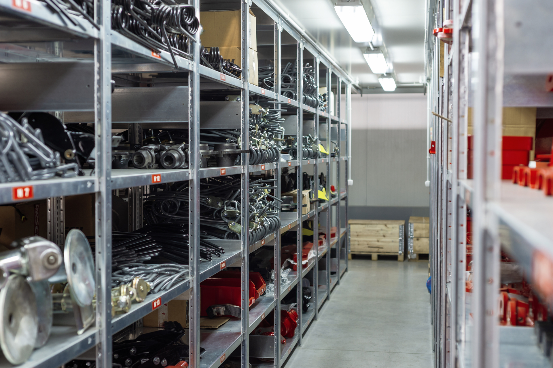

Good spare parts management is much more complicated than many people believe. It’s not a matter of having a spare for every contingency. In fact, such a strategy can easily increase rather than decrease downtime.
First, consider the fact there is only so much space in a given facility. If you had a widget factory and 100% of its space could be used for making widgets, that would be ideal. But it is unattainable. That space must include employee lavatories, break rooms, administrative offices, places for the infrastructure (electrical service and power distribution, water and sewer, plant air), shipping and receiving, packaging, quality control stations, meeting rooms, raw materials, components, and so on. And, of course, the maintenance shop.
Somewhere in what is left must be shoe-horned in a spare parts room or similar area. Just as with those other uses, spare parts space allocation comes at the cost of the space available for making those widgets.

One problem that arises is if you need that article, you might waste many hours trying to find it. This also is a problem with spare parts inventory. How do you catalog and locate all that stuff? And how do you decide which inventory is critical enough to track and maintain versus inventory that is just clutter kept for a statistically insignificant risk of needing it someday?

One way to reduce the spare parts count is to standardize. At a three-shift, multi-building plant in Tennessee, lighting systems had been installed as many different, unconnected projects. Consequently, there were dozens of different lamp models, with spares for each. The amount of space devoted was, as the plant engineer described it, “insane.” The plant engineer proposed replacing the older lighting systems such that they would use the most commonly used lamp (in this case, 277V fluorescent).
What was done instead was to get rid of the spares entirely and hire a relamping service. However, all future lighting projects were standardized. The standardization idea for other spare parts took hold, and within a year the storage requirements decreased by 40%. Another 30% was gained by eliminating spare motors and transformers, and the racks of EMT and rigid (plus the associated fittings), under the theory the plant was already built and such items should be ordered specifically for whatever projects required them.
This 70% reduction in materials storage space allowed relocating the spare parts operation right next to the maintenance department in a cage instead of in a big room. The former spare parts area was then used for two small additional production lines that brought in enough revenue to pay for several maintenance salaries.
