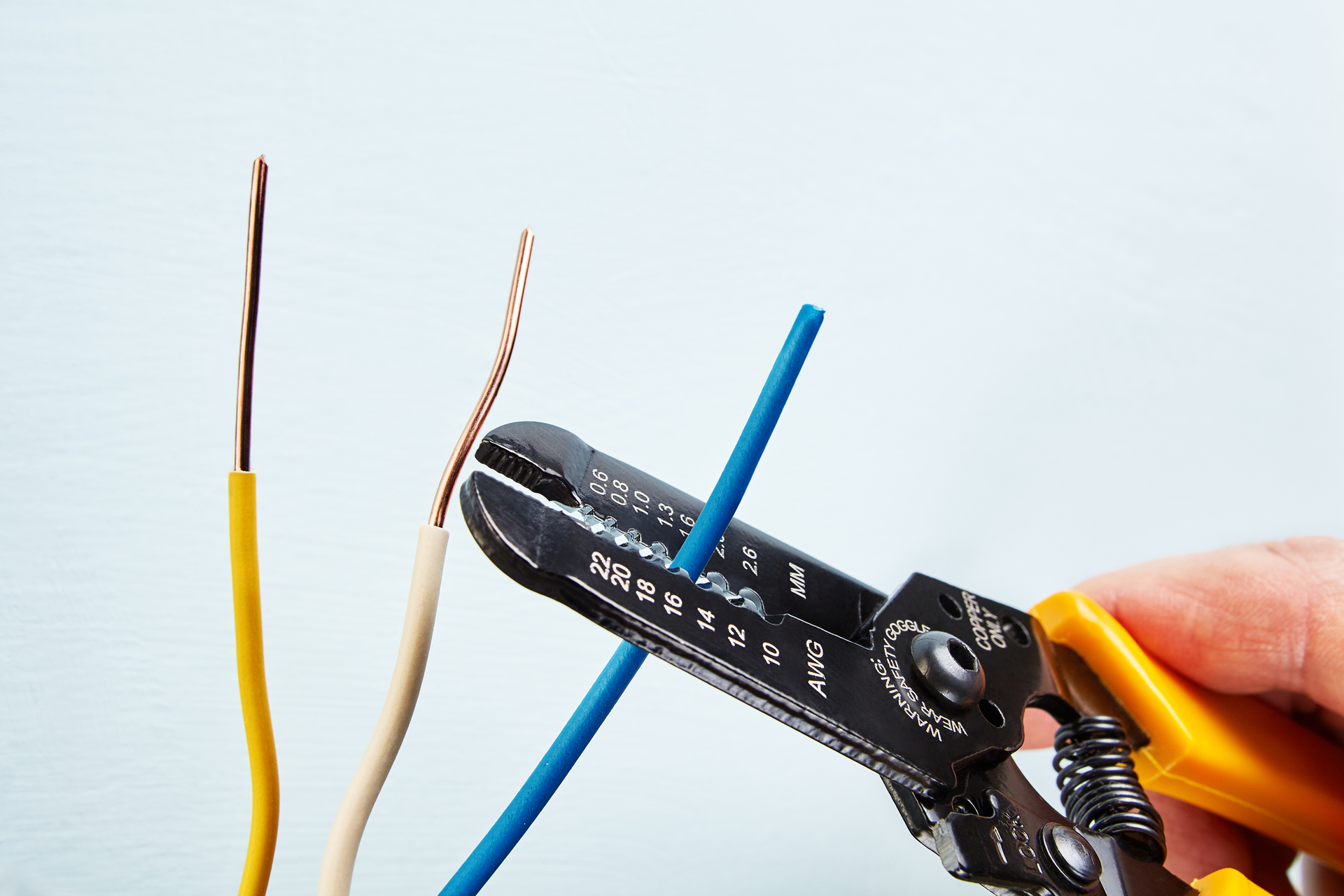

If the installing electrician uses the universal-type of wire stripper (you can recognize it by its clamping jaws), it is very easy to strip the sheathing without damaging anything. It also will allow you to quickly strip individual conductors. In fact, it works on any size wire, until you get into things such as feeder cables.
Instead of using the backstabs, use needle-nose pliers to make a proper curl at the end of the conductor and wrap it around the appropriate screw (neutral to silver screw, hot to bronze screw) so that tightening the screw tightens the loop. This will not come off even with a strong tug. And you have more contact area engaged.
Incorrect stripping length is a common problem; here is how you avoid it. If you look on the back of a typical receptacle, you will see a wire stripping gauge. That shows you how much insulation to remove. Set your fancy strippers to remove that much, and you will not get insulation under the screw or have excess bare wire jutting away from the terminal. After you do this a few times, you can probably eyeball it going forward.
