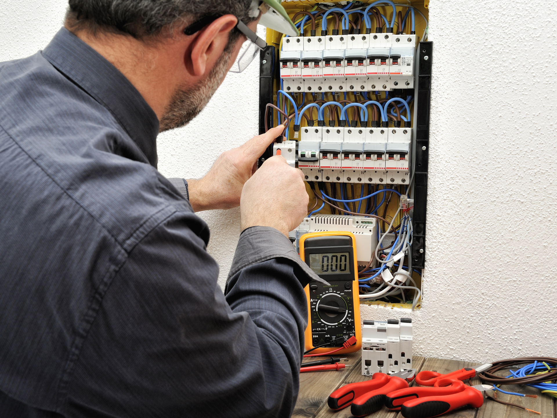

You work for a small electrical services firm. You were sent out on a residential job to replace incandescent can lights with LED can lights and to install LED-compatible dimmers. This work is in two bathrooms, the living room, and the kitchen. The kitchen and living room were no problem, but when you opened the breaker indicated (on the panel directory) for the bathroom lights, the lights stayed on. The homeowner doesn’t want you to just flip breakers until you find the right one. He says you should be able to work it hot, using an insulated screwdriver. How do you resolve this?

You may simply need to correct the directory. Draw it on paper and through testing, properly identify the circuit(s) in question. It isn’t necessary to remap the whole thing and further annoy the homeowner. It is necessary only to find which circuit powers the lights and then identify which circuit it’s swapped with in the directory. Also note there’s no way the 15A breaker for these lights was swapped with the oven circuit or the HVAC circuit. Unless something epically idiotic happened, you can confine your investigation to the 15A breakers.
Let’s say the directory tells you that breaker 6 is for those lights. The most likely problem is the labeling is swapped between two adjacent breakers. If breaker 4 says bathroom receptacles, try operating that to test the lights. Or it may be breaker 8. This simple testing can provide a quick resolution. But let’s say it does not.

Now, remove the load center cover and identify breaker 6. Your hands won’t be near live conductors, but wear your gloves anyhow (the circuit conductor might be fed from another circuit, backfeeding the breaker). Snap out breaker 6. Keep in mind that it’s easy to inadvertently pop out an adjacent breaker, and breakers may be under load when that happens, which is bad. This is why you shut things off beforehand.
With breaker 6 removed from the panel power strip, use your voltage tester on the conductor leaving the breaker. It should be dead, but what if it isn’t? If the conductor on the load side of the breaker still has power, this circuit is cross-wired with another one, probably at a switch or receptacle. It’s unlikely this would happen during construction, so ask the homeowner about anything that was added or changed. You may be able to spot the “amateur work” from visual clues such as a crooked wall plate or a receptacle that is loose. If not, then you’ll have to methodically check behind every wall plate until you find the problem.
If the conductor does not have power, then try to operate the lights.
  • If they came on before but do not come on now, this is the correct breaker. It just does not open, so it needs to be replaced. The 15A breaker typically used in this application is less than $10; make sure the replacement is the same brand as the one you’re replacing and is for a load center.
  • If they came on before and still come on, this is the wrong breaker. Use your directory drawing, not the actual directory, to remap the breaker layout. Only when you have verified you have a correct drawing do you transfer the update to the directory. Else, you might make a mess of the directory.
