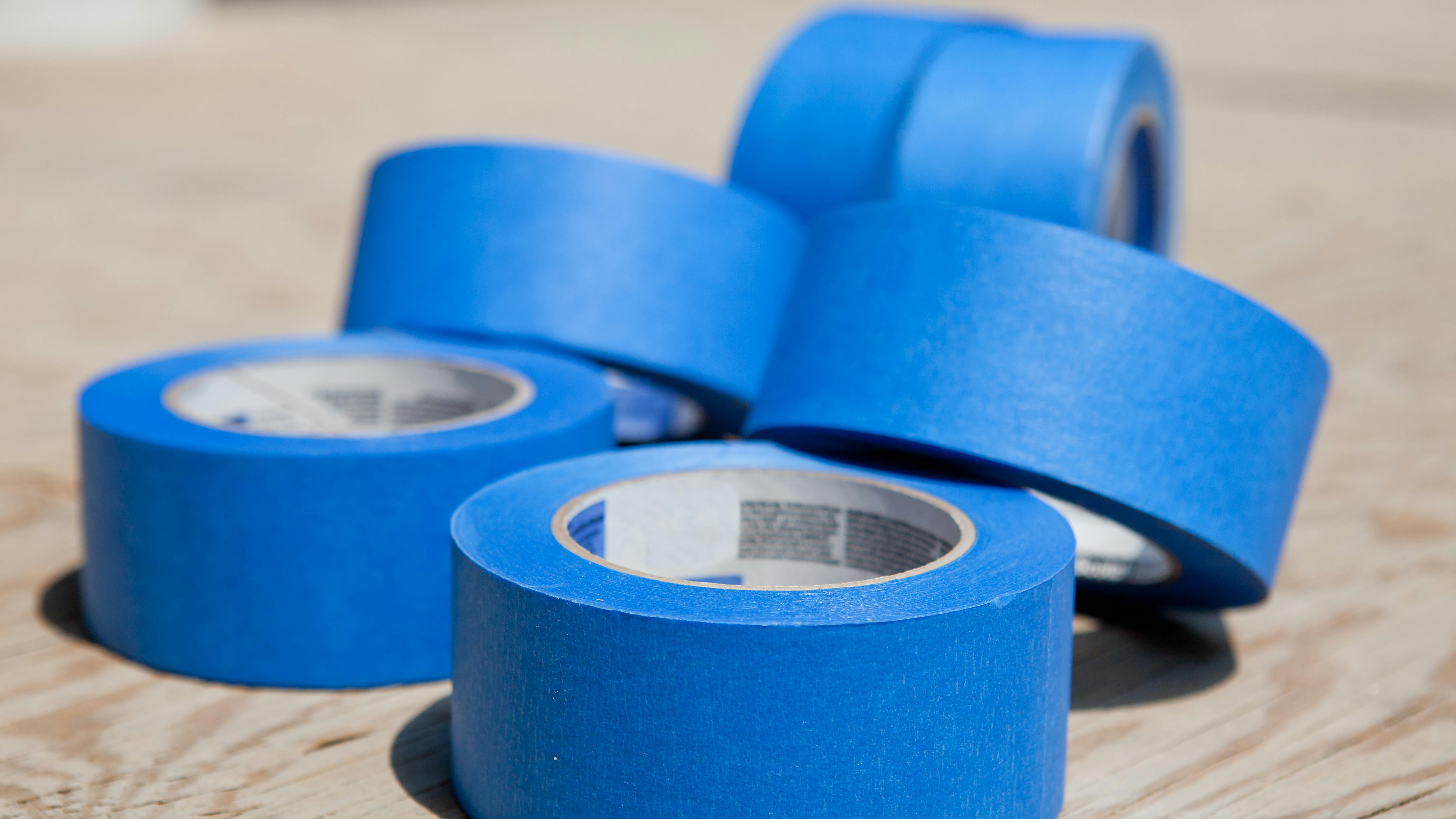

Painter’s tape. This is the modern-day equivalent of masking tape, distinguished by its blue color. Of course, you can use it to protect from overspray (or over brush) while painting. But you can also use it to mark things, seal bags closed, hold down portable cords, cover saw teeth when the blades are stored, mark off areas on the floor, or temporarily mount signs. You can also use it to make a quick straight edge. If you’re drilling wood, you can prevent splinters by covering the “exit” before you start drilling. If you are cutting or drilling metal, you can double this tape back on itself and stick it on the work surface to catch most of the metal particles. It’s not considered to be insulating tape, so don’t use it for any purpose related to that.
