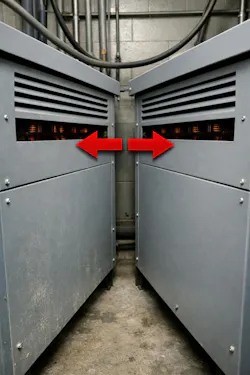

- Plan equipment orientation. Don’t, for example, face transformer vents the wrong way (Photo 1). They cannot be facing each other (unless they’re far apart). Nor can they face a nearby wall or panel. And you don’t want a transformer vent facing where an electrician would stand to perform routine maintenance. You also need to ensure there’s adequate airflow among all equipment [Sec. 110.13(B)], nothing blocked from the air it needs for cooling. After all this, the final equipment orientation may force you to change the dimensions you calculated in the previous step.

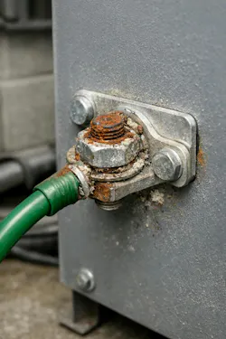

- Grounding and bonding. Don’t tighten connections as part of maintenance — this will just cause them to fail prematurely. If assembled properly, they will hold their mechanical integrity unless subjected to corrosive elements, severe vibration, or misguided “tightening” (Photo 2).
