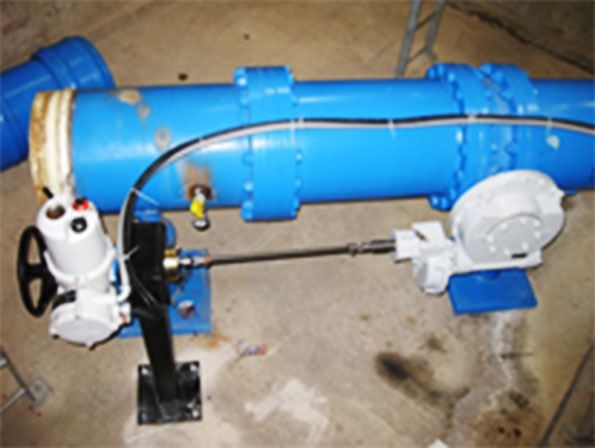

    Because VAMs typically have self-contained controllers (i.e., forward/reverse contactors) and no self-contained breaker or fuse disconnecting means, this meant that a local disconnecting means had to be provided within sight of the VAM. Even if the VAM was protected by a remote thermal magnetic breaker or fuses, there still had to be a local disconnecting means within 50 ft of the VAM and within sight.
    In some cases, adding this disconnecting means created more of a hazard as a point of failure during a fire than it added for safety. In these cases, it was a common practice to either leave the disconnecting means out within sight of the VAM or cover it up with a fire blanket, which negated the need to have one there in the first place. So, the general rule now is that if there isn’t an additional hazard presented by adding the local disconnecting means, it must be present. However, in cases where it presents additional hazards, such as for a unit block valve or an emergency shutdown valve, then it can be eliminated.
