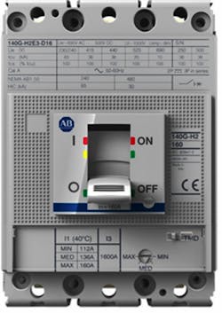

Instantaneous trip breakers do exactly what the name implies. When the current in the circuit reaches a value that the breaker trip mechanism is set to, it will trip off instantaneously with no time delay. Instantaneous breakers are magnetic trip only. Instantaneous breakers are also referred to as motor circuit protector breakers or MCPs.
This is what a typical instantaneous trip breaker looks like. (Photo courtesy of Allen-Bradley/Rockwell Automation)

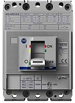

Sizing an MCP is relatively simple. For example, let’s assume we have a squirrel cage, 25-hp, 480V, 3-phase, Design B, energy-efficient motor. Using the values in Table 430.250, we find that the full-load continuous current to be used in our calculation for the breaker is 34A. In Table 430.52, the initial maximum setting is 1,100% of 34A, or 34A x 11 = 374A. The reason for the 1,100% multiplier is to allow the motor locked rotor current to occur without tripping the breaker. The MCP chosen may have a continuous ampere rating of 50A in this case, and the settings on the dials on the front of the breaker may be set anywhere from a minimum of 30A to a maximum of say 500A, for example. Care must be taken not to set the dials any higher than the NEC allows, which in this example is 374A. The dial(s) may not have ampere ratings on them, (see Photo). Many times, there are alpha characters, numerals, or min/mid/max indicated for the settings, and these characters correspond to a defined ampere rating.
Indiscriminately cranking the dial(s) wide open to the maximum could — and probably will — create a Code violation. Many times, electricians don’t have the dial setting data available to them when commissioning the installation and may end up “winging it” (guessing at) the settings so that the motor will start and not trip the breaker — having no idea what value the breaker is set to trip at. Always use vendor data to set the breaker trip value in accordance with the values allowed by the NEC.
