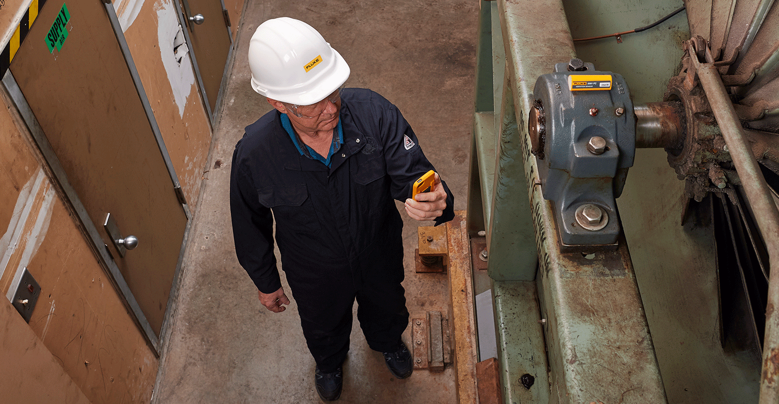

Some remote vibration sensors are small enough to fit in difficult-to-reach locations (see the Photo on page 34) and affordable enough to install on multiple locations on equipment (for example, four test points). The data generated from many sensors is wirelessly transmitted and stored using cloud-based condition monitoring software. Many software programs offer an app that can be downloaded to a smart device or PC. With this capability, teams can remotely monitor equipment health and review historical data at anytime and anywhere with a Wi-Fi connection.
