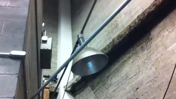

Russ finds a violation of the support requirements for EMT. He shows us a 25-ft horizontal run of pipe without a single support. The installation is a clear violation of the requirements set forth in Sec. 358.30 of the 2014 NEC.
