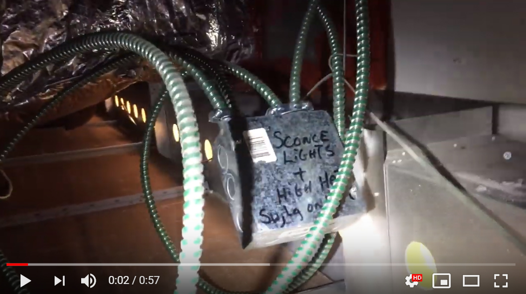

In this video, Russ found more unsupported AF cables and a junction box that violates the NEC.
Russ poked his head up in a suspended ceiling space and found yet another non-compliant electrical installation. These unsupported AC cables and junction box violate the 2017 NEC requirements outlined in Sec.314.23 and Sec. 320.30(C).
