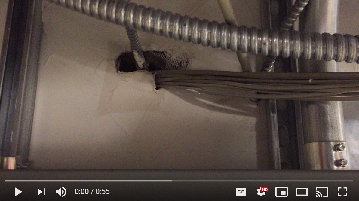

Moving Violations Video No. 206: Plug it Up!
It’s obvious in this video that the installer doesn’t know the fire-stop requirements outlined in the 2017 NEC. As outlined in Sec. 300.21, openings around electrical penetrations through fire-resistant-rated walls shall be fire-stopped using approved methods.
