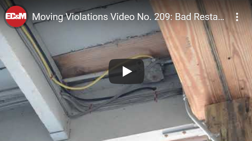

Russ LeBlanc discovered this NM cable installed in a damp, outdoor location.
NM cable installed in an outdoor damp location? I don’t think so! Russ found this wiring violation (Sec. 334.12) under the outdoor deck of a restaurant. The wire run also lacked proper support per Sec. 334.30.
