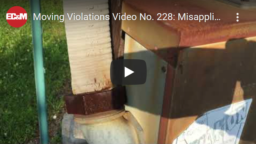

In this episode, Russ finds some violations on a pole-mounted service riser.
Dec. 3, 2020
In this episode, Russ finds some violations on a pole-mounted service riser. The set screw connector on the EMT is not listed for use in a wet location. This is a violation of Sec. 358.42 and Sec. 314.15 of the NEC. In addition, the liquidtight flexible metal conduit seems to be breaking down from sunlight exposure. This could be a violation of Sec. 300.(6)(1).
