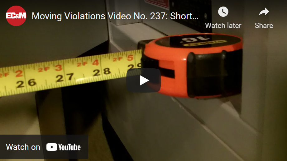

Talk about a tight work space.
April 15, 2021
Talk about a tight work space. As Russ shows us in this video, there’s a clear violation of working space depth in front of this 480V panelboard. Section 110.26(A)(1) of the 2020 NEC requires 4 ft of working depth at the front of the panel because it faces another panel on the opposite wall. There’s currently less than 30 in. of clearance.
