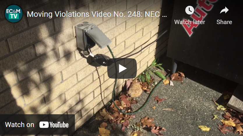

Russ found this receptacle and cord arrangement at a local car wash.
Oct. 7, 2021
Russ found this receptacle and cord arrangement at a local car wash. Although the vending machine cord is GFI-protected, the receptacle box cover violates Sec. 406.9(B)(1) because it’s not weatherproof when the cords are plugged into it.
