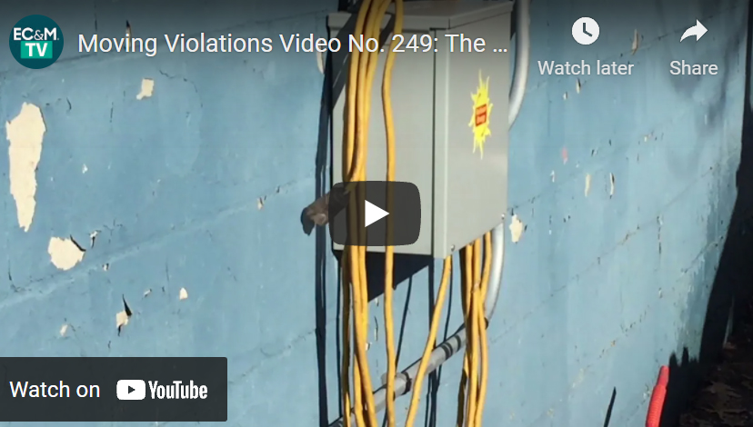

Russ noticed this bright yellow extension cord coiled up on the outside of this concrete block building.
Oct. 20, 2021
Russ noticed this bright yellow extension cord coiled up on the outside of this concrete block building. Upon closer examination, he noticed it disappeared through a hole in the wall. This is a violation of Sec. 400.12(2).
