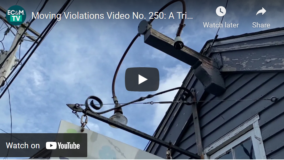

    Russ ran across this installation in front of a small store.
    Nov. 4, 2021
    Russ ran across this installation in front of a small store. You can’t use EMT to support a luminaire. This is a clear violation of NEC Sec. 358.12(2). This EMT is also unsupported, which is a violation of Sec. 358.30. Learn about a third violation by listening to the video.
