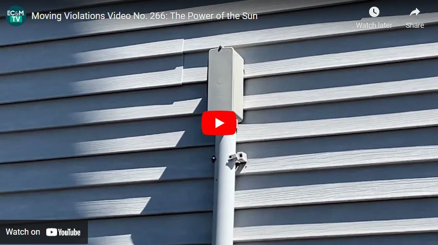

In this episode, Russ shows us why it’s important to use listed products in approved applications. This installer used the wrong type of support clips on this residential service drop installation. Every single clip is broken because they’re not sunlight resistant. This is a violation of Sec. 300.6(C)(1) of the 2020 National Electrical Code (NEC).
