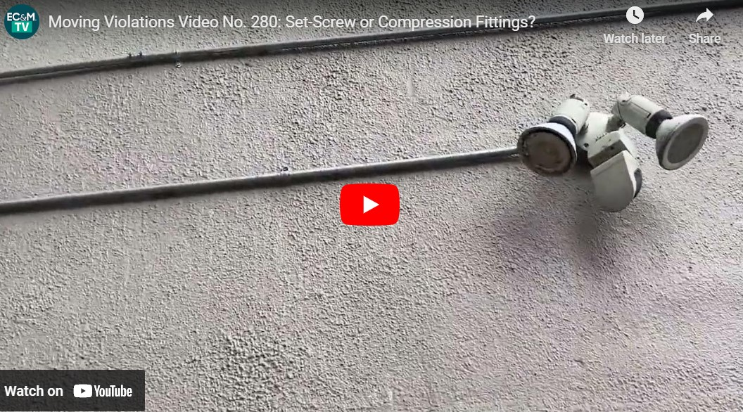

Russ shows us an installation using electrical metallic tubing (EMT).
Feb. 2, 2023
In this episode, Russ shows us an installation using electrical metallic tubing (EMT). The EMT is mounted on the exterior wall of a building and uses a combination of set-screw and compression-type fittings. The compression fittings are Code-compliant whereas the set-screw connectors are not. The use of set-screw connectors in this setting violates the requirements in Sec. 314.15.
