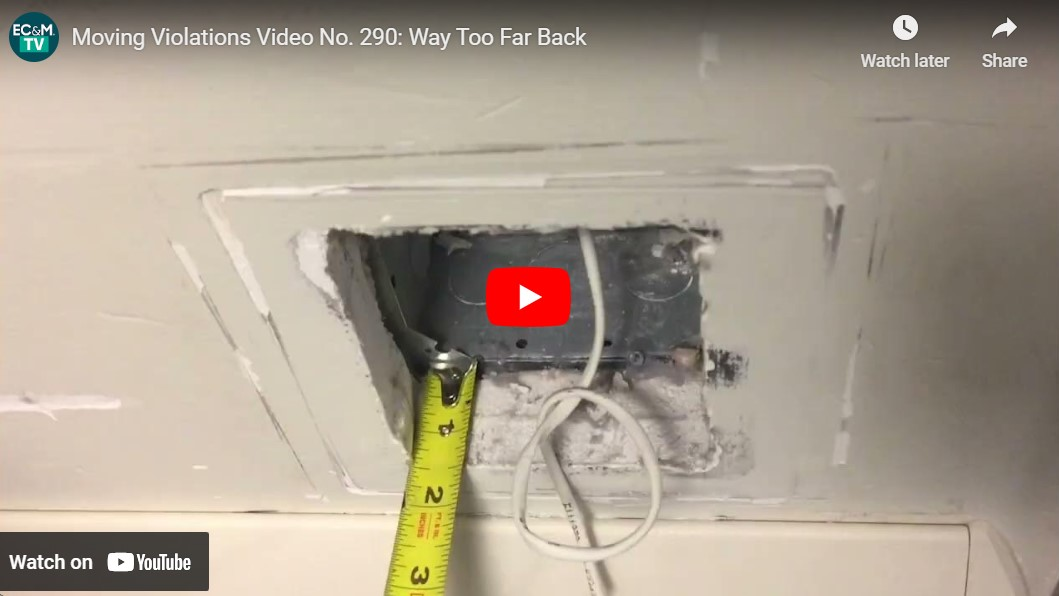

Russ examines a box that was set too far back.
In this episode of Moving Violations, Russ examines a box that was set too far back. While some may say a box isn’t needed with a Class 2 circuit, Russ argues that, since there is a box installed, it must comply with Sec. 314.20. Watch the video to hear his explanation of this NEC violation.
